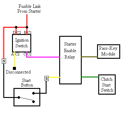

http://www.austinthirdgen.org/mkport..._continued.gif

Here is the diagram I made up when I installed the push-button start. I basically just disconnected the yellow wire that goes to the start enable relay at the base of the steering column and connected it to a relay activated by my button. I probably could have run it straight through the button since its rated at 30 amps, but I figured the relay was a safer way to do it. And I have a whole bunch of them laying around.
88gunmetalgta - I thought about doing that with mine. It wouldn't be much more difficult than what I did, but with having a manual choke on my carb it doesn't like to start some times. I also had some fueling issues on startup when I did this and it would start and run till the fuel bowl emptied, then I'd have to restart it.
The other problem with letting them get as far as the fuel in the bowls is what happens when they run out. If you live on a hill like I do then they end up ramming the car into something to get it to stop rolling down the hill.
I also can't leave my keys in my Camaro because I shaved the door handles and the remote for the popper is on my keyring.
