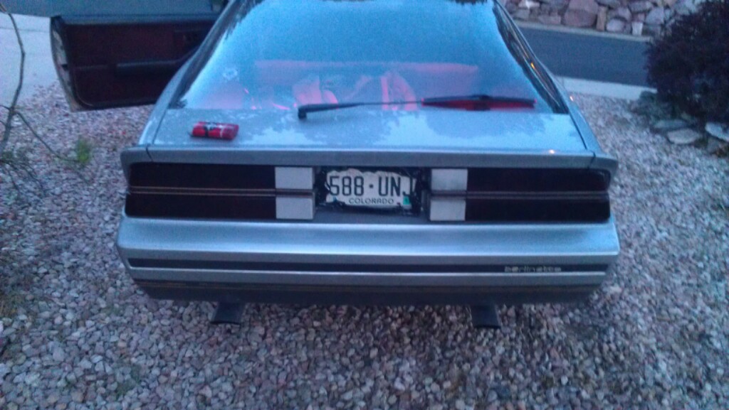

just recolored and smoked tail lights in prep for this, if im not already, please put me down for one!!

That sounds great! Do you have a picture by any chance? I'd love to see them. You can see my non-smoked red tail lights on the previous page.
I got you on my list already, no worries, you will get a unit.

sweet! thanks, cant wait to put these in and yeah this pic is all i have for now, not the best quality but what do you expect from a cell phone haha

Nice picture, looks great. I hope you don't get busted for "tail lights not reflective red". These will be great with sequencing bulbs. Can't wait to see the video when you're done installing your STS unit. Oh right, I need to make some first.

yeah between the HID headlights, red mood lights and these tail lights the car looks good but isnt exactly up to DOT regulations haha. my neighbor is a cop though and hasn't said anything is worthy of a ticket... yet. Any idea of when you should have these done? And just to clarify, when i first saw these i thought it was an LED panel inserted into the tail light housing that will do the sequence . but now reading on them more its just the wiring set up to sequence the lights and it can work with either incandescent or LED bulbs as long as the right flasher is used?
