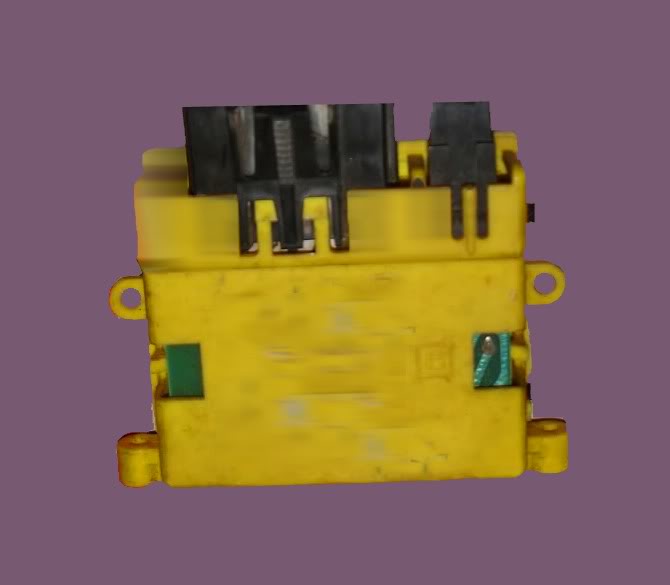

Gain access to the buffer which looks like this:
It’s located behind the IP on the right.
Connect your oscilloscope to terminal A yellow wire to make sure it’s getting a steady signal.
The tan wire then goes to the speedometer unit.
If it gets to the speedometer but the speedometer does not work, have it repaired or replace the unit.
Happy Racing!
