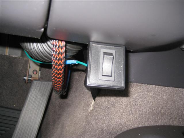

It depends on where you want to mount it. I am not familiar with the Camaro interior but on my GTA, there is a small plastic section along the bottom of the dash that is not connected to it. Works great for such things. (Pics 1 and 2). You could also just hang it from the bottom of the dash as in pic 3.

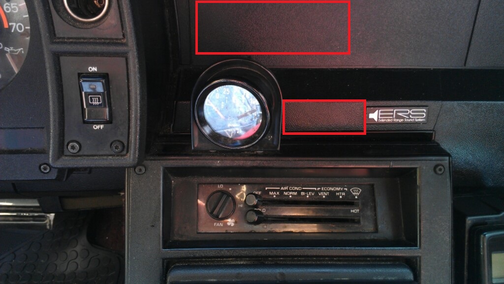

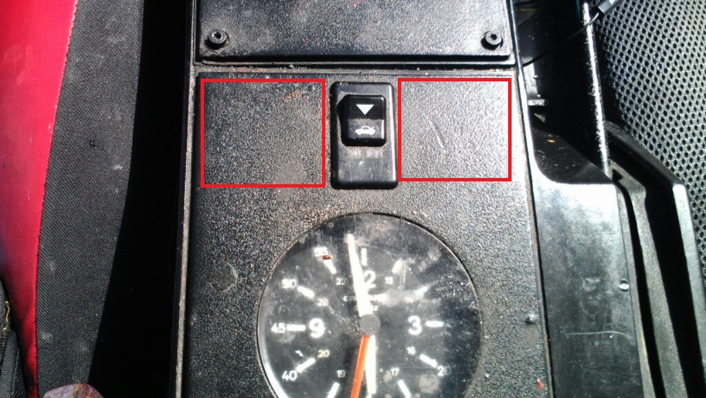

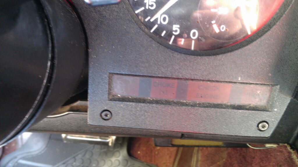

I wish i had those spots they would be perfect! as the pics show, my car has lights taking up all those spots, and i would hang it from the dash, but at 6'2" my legs are pretty much touching the dash as i sit so i would be knocking it with my leg all the time. originally i was gonna have a rocker switch that would mount perfectly next to the hatch release as the pics show, but QTP does a momentary toggle switch which would be a little awkward and easy to bump there. So for now the only place i can find is above the stereo, but i may check out those lights on the base of the gauges because it looks like maybe 2 of them arn't being used

These are the areas above the radio im thinking of.

Those all look like good spots. I would rather take my console apart than my dash, but that's just me. I noticed in the second pic that you have a small piece of trim right under the steering wheel but I don't know what is behind it. Possible location ? (If your knees don't hit)
