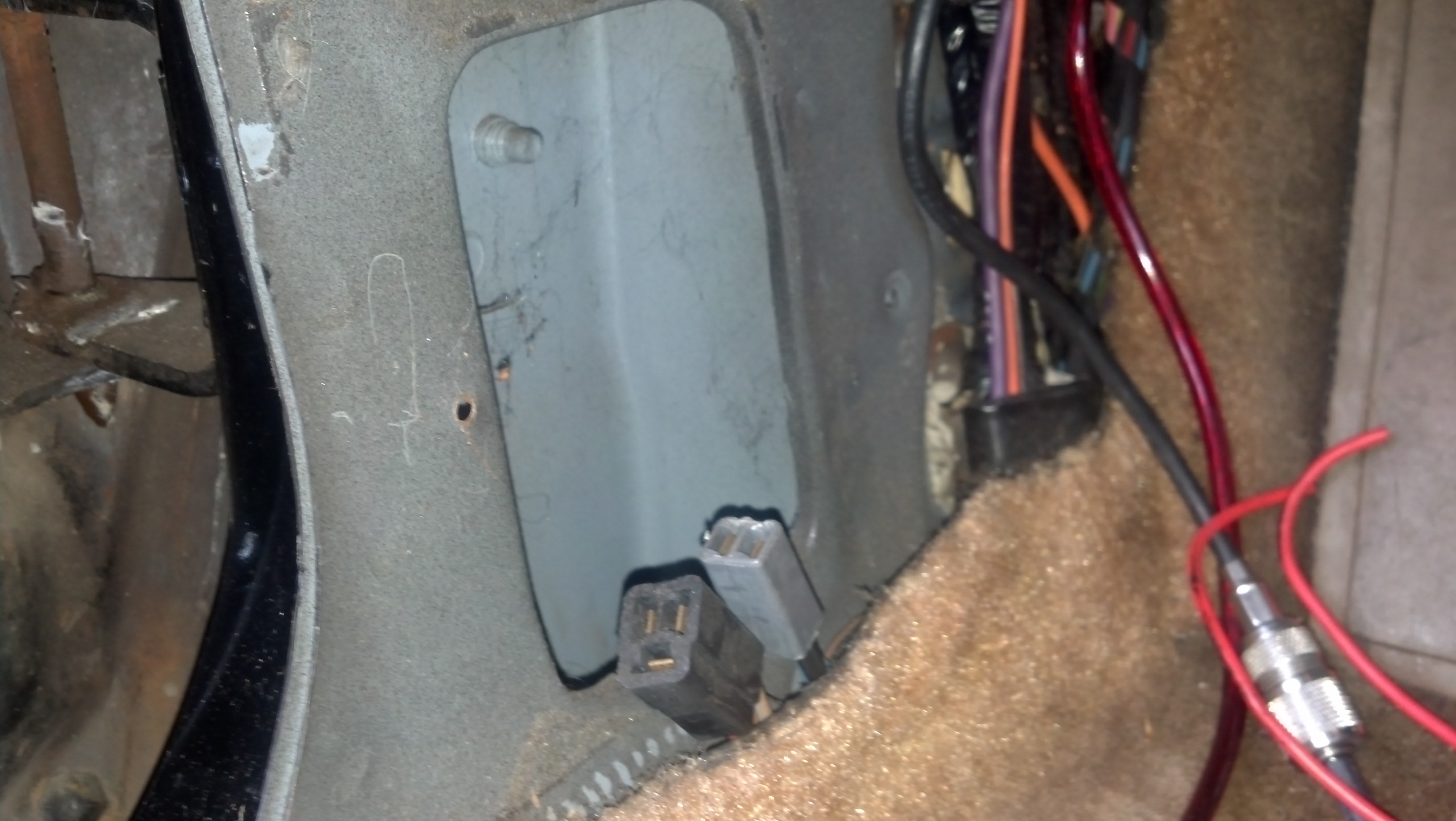

Got it off. Let me guess, those two plugs belong in the missing relay, that screws into that hole on the frame.

Re: Cannot Fix Power Door Locks
Relay is missing. That is the correct area. There is your problem!

Here is how the PO did my door locks (before I bought the car).
used I think these actuators:
Cheap Cheap

Wow Veaceonee it looks like your actuator was moved from it's stock location (bottom right where the rivet holes are)

Btw i like the way that guy wired the actuator lol
