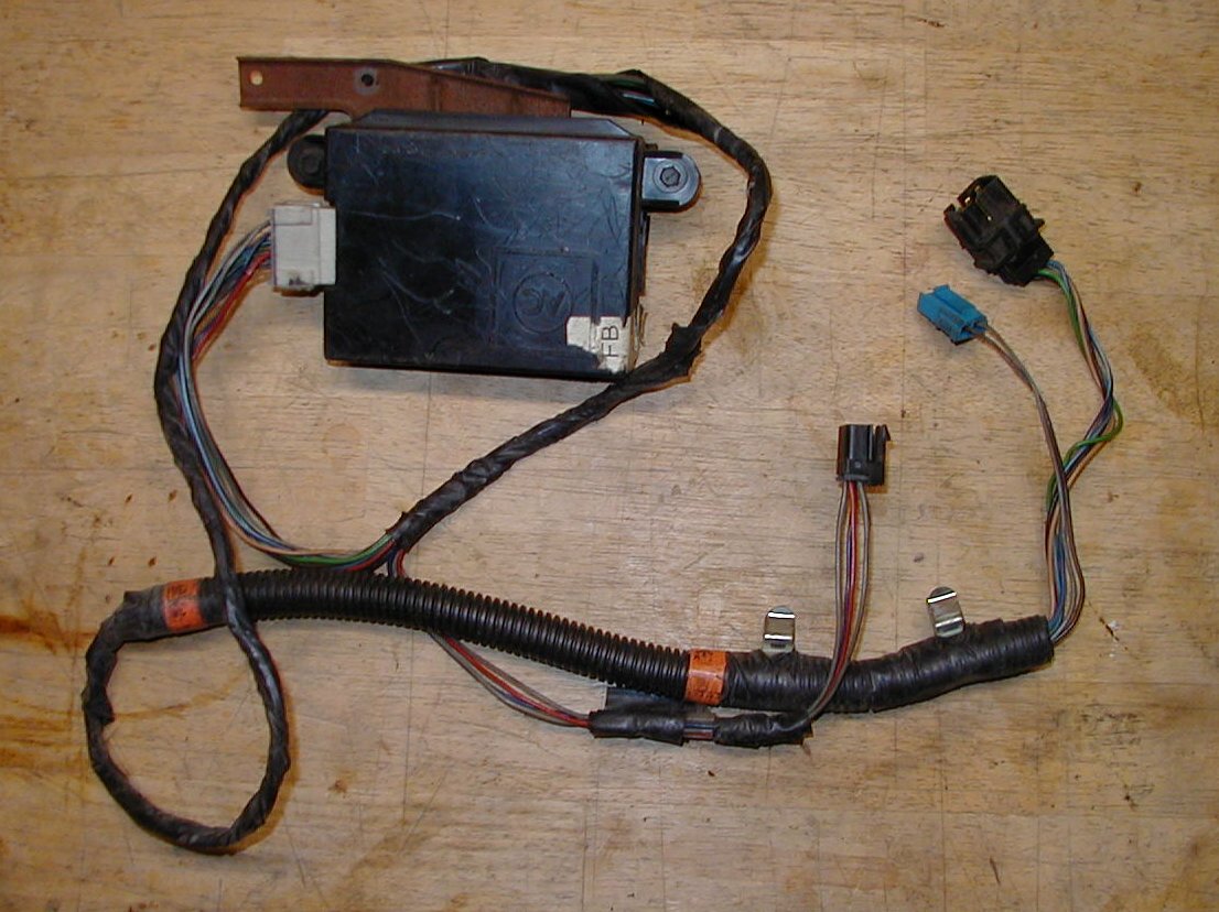

Here's a pic of the Cruise system system from an 86 :
I'm pretty sure the wiring is spliced in parrellel under the factory black tape right before the split. The 90-91 systems might be a little different - but should be 'similar'.

Here's a pic of the Cruise system system from an 86 : I'm pretty sure the wiring is spliced in parrellel under the factory black tape right before the split. The 90-91 systems might be a little different - but should be 'similar'.
See...I can't find the little black plug with the 4 wires on it..??? Where TF is it!!!!???? Lol

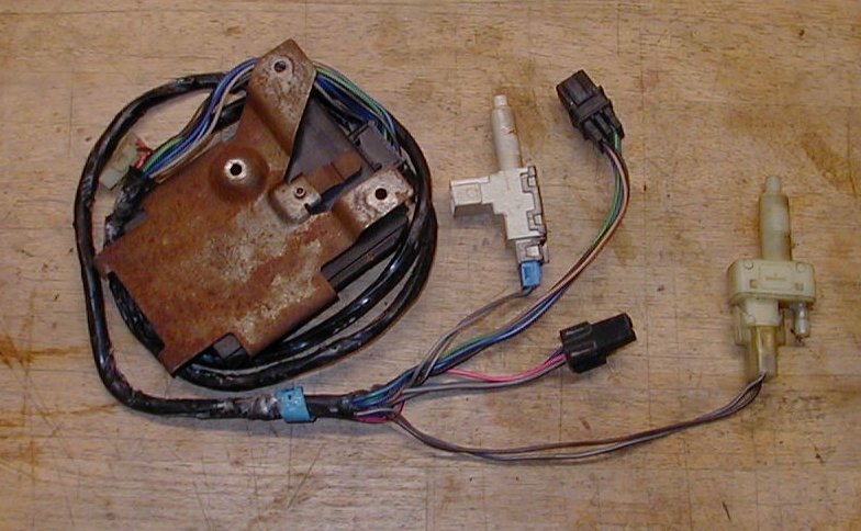

The connectors changed from year to year. I could be wrong, but I'm pretty sure this is the 90-92 'dash-side' Cruise set-up from an automatic.
