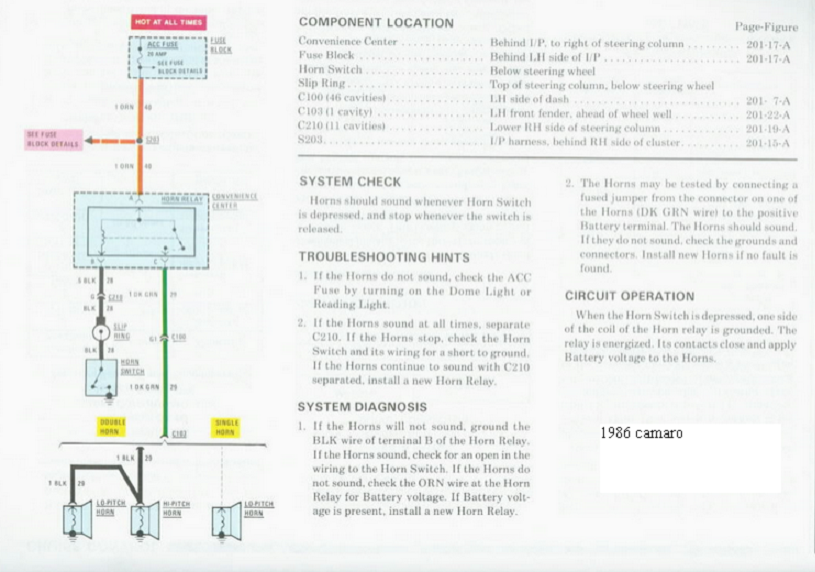

It's best not to guess at what the problem might be and do some basic troubleshooting. The horn circuit is pretty simple.
See the attached pages from the Camaro factory service manual. Firebirds should be wired the same.

In other words , troubleshoot it correctly as Paulo said , and repair the failed component . The entire system consists of two horns , one relay , one switch (with a spring loaded contact called a slip ring in Paulo's schematic to accomodate turning the wheel) , one fuse , and some wire .

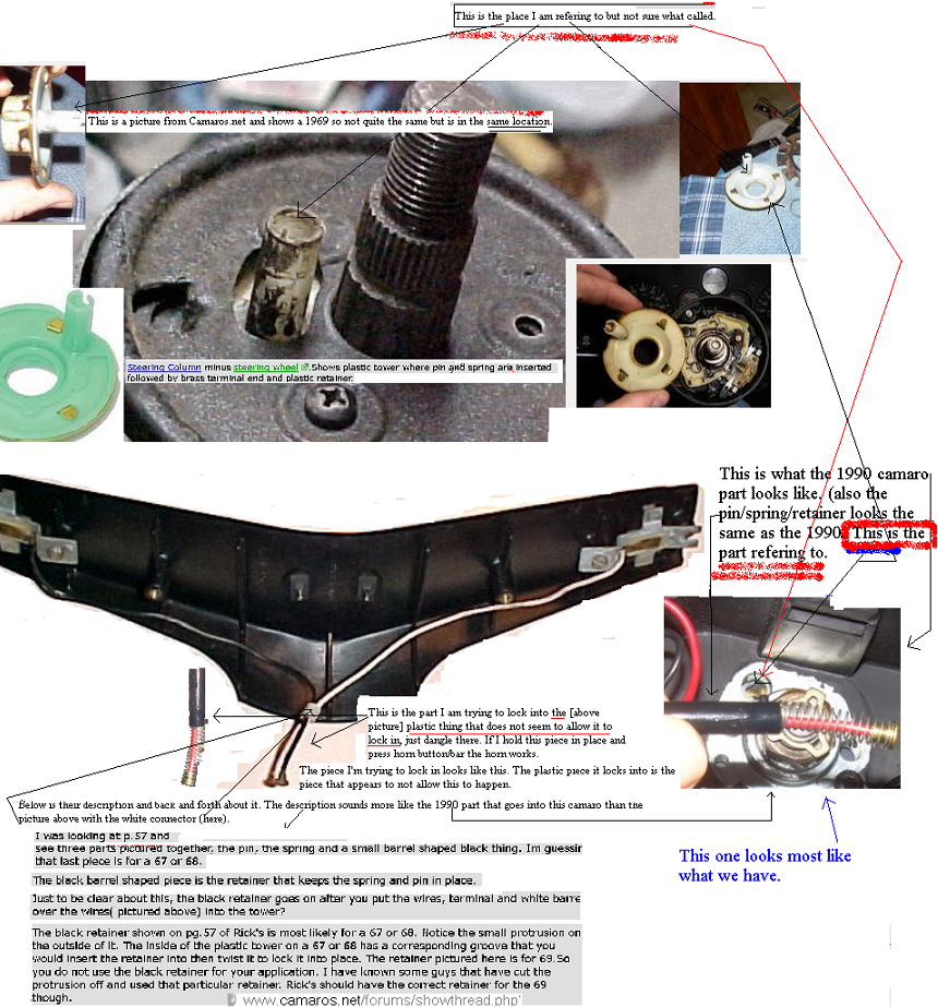

Its been a while since I worked on the horn trouble in the car I babysit, but besides checking the fuse (& if it is good) I remember checking the horn itself under the hood. First I checked to see if the wires were connected (because sometimes it can be just a wire loose or disconnected). Then I used a piece of wire to run from the horn (this one had two) under the hood to direct battery power positive. The horn made horn noise.(I don't remember if the ground wires looked good or if I connected a ground wire as well). So knew the horn worked. I gave once over to wiring that I could see from horn till couldn't trace any more.Then I checked the wire coming into the fuse box-good. My wire from fuse box went into the steering column to a horn switch). I ended up pulling fuse for airbag (very important), waiting at least 10 minutes, disconnecting the battery(under the hood), then pulled the steering wheel (borrowed puller from friend otherwise would have borrowed one from O'Reilly auto). (If that ends up being what you need to do, this is a camaro that I babysit so I don't know if it is the same.). On the attachments "steering col remove camaro" don't just pry off the cover when it says to do that & that it might crack. Mine needed the lock plate compressor tool for both parts because there were 2 lock rings instead of one. I hope you don't need to get into the column though.

Also, if you do get to the point that you need to pull the steering wheel to check the horn button or pin with a spring insert, be very careful when removing the airbag, note with a marker where your "clockspring" is facing (like in the attachment), be very careful of the plastic horn ring. I found this one broken & needed to either buy one, or do like I did and use a heated plier held paperclip to slowly, carefully melt a new path to hold the pin and spring in that should lock into the plastic horn ring, in order that when you push on the horn this part can make contact so the horn would blast. I hope this makes sense. Any questions I will do my best to explain.

My post #14. The attachment "files" steering clo. remove camaro & tilt steering cloumn dis. no pics go together. They are done by the person I copied to do my work. I did not do these pictures of any work I did. They were just so helpful to me that I thought they might be to you.
