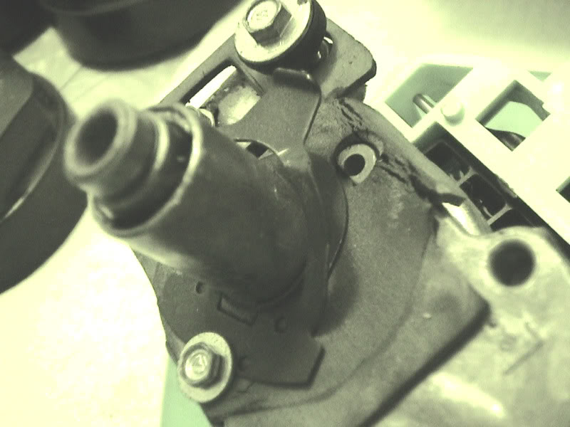

I've found that dropping the column is an easy way to access the speedometer cable release.
Pull on the cable on the engine side of the firewall to remove excess slack.
Remove the fasteners holding the cluster to the instrument panel.
Reach in and around thru the opening above the column to get to the locking tab on the speedometer head. Press the tab while pulling the cluster.
