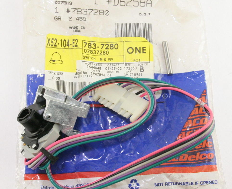

Re: CANT FIND THE CONNECTION UNDER DASH FOR WIPER STALK
Hi, the problem is the switch in the steering column. It is broke on the inside. When I put fuse in the wipers will not turn off. Been looking for a switch they run from $90.00 to $138.00. Kind of expensive right now. This one is $90.00 I think that is the correct one?
