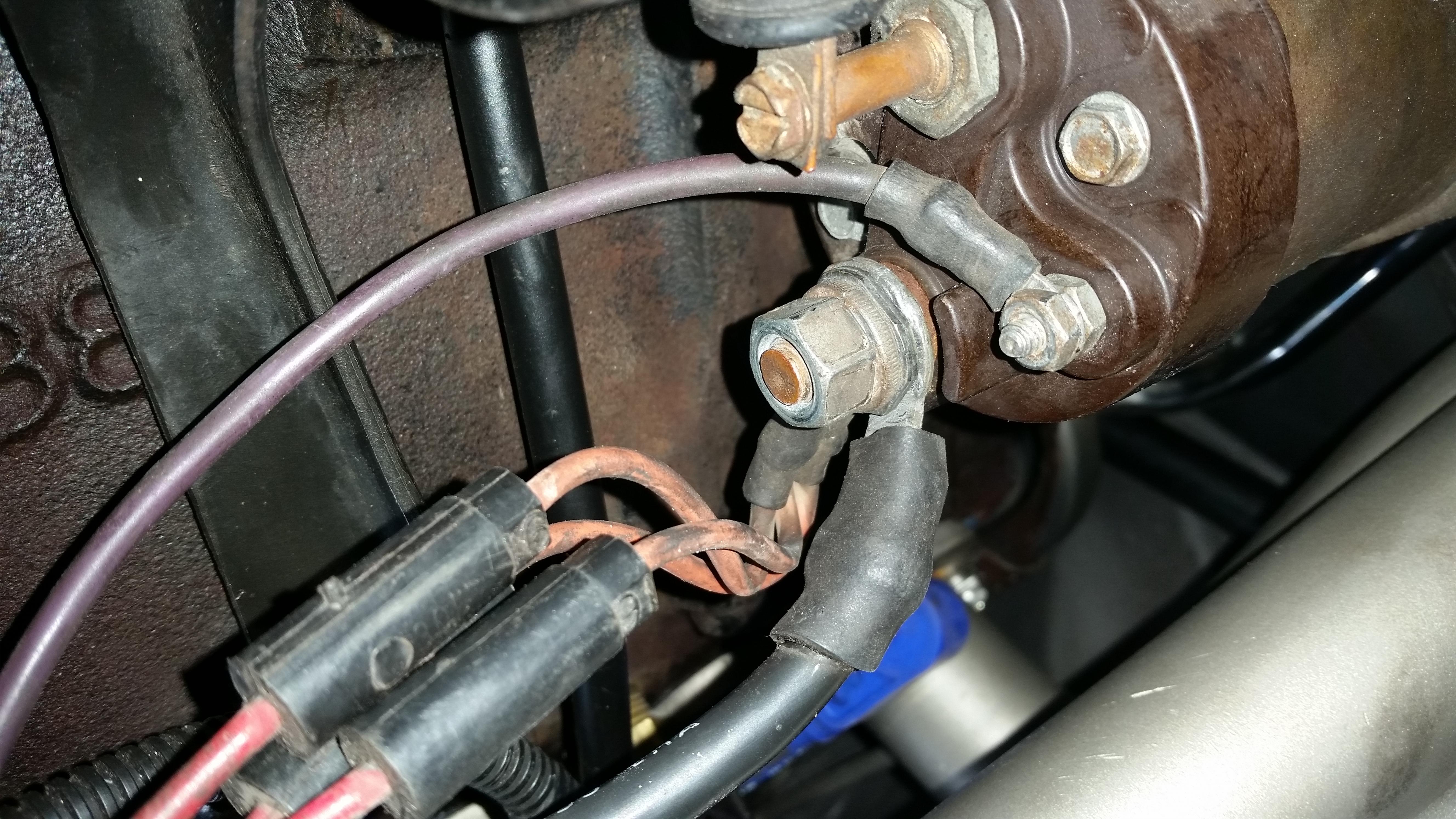

Hi Guys, I have an 88 camaro and just got done finishing up my header and y-pipe install. I forgot to take some pics of the starter wires before removing them. Car power is on when I turn the key but no click at all. What do I have wired wrong with the starter? Picture is attached. Thanks!

I don't see anything wrong with your starter wiring. Try cleaning all the terminals. You would be amazed how much voltage drop a little corrosion causes.
Purple wire is the switch that turns the starter on and off. If you want to troubleshoot, then remove the purple wire (for your safety so engine doesn't crank) and have somebody turn the key switch to crank position while you measure voltage on the Purple wire. You should see battery voltage whenever they try to crank. If not, then you have a problem with the starting circuit. If there is voltage then you have a problem with the starter solenoid.

Hi QwkTrip, thanks for the quick reply! The starter worked fine prior to removing it from my car to do the header install. When it was off the car I cleaned the terminals on all the wires that connected to it to get the rust off of them so that shouldn't be a problem. I'll try your advice on what you mentioned above.

I measured the voltage of the purple wire with it off while cranking and it showed voltage. It must be a bad solenoid then on the starter. Very weird how it worked fine before I took it off, must've been on it's way out.

Purple wire looks to be on the wrong terminal.
The "S" terminal is usually the one closer to the block. Looks like you have it on the "R" terminal. Can't see clearly if there's another small terminal in the pic though; but there should be.

Here's a better picture of they way I have it wired. Looks like it is in fact on the "R" terminal. Guessing it should be on the one across from it? If so I'll try to switch it over quick and try it out. Thanks for the help guys!

Yup, the little "R" probably means that's the "R" terminal...
Definitely, changing it to the "S" terminal (the one with the little "S" next to it that you can see part of in the pic) will increase the odds of it working. No guarantees but it's worth a shot.

Switched the purple power wire from the "R" terminal to the "S" terminal and it fired right up! Thanks for all the help guys!
