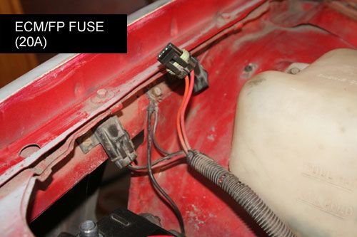

The fuses you're looking for should be square, with a black plastic weather-protection cap. They're bolted right in front of the battery (facing the car, they're under that lip between the battery and the coolant recovery tank.) under the fender, the fuel pump one has a orange and red wire leading into it. I think what you've found is a unrelated fusible link?

Re: Fuses at the battery?
They should look like this (not my picture but you should get the idea)-
You take the black cap off and your 20amp fuse goes into the metal prongs. Good luck!

the black wire with cylindrically shaped plastic piece and red wire coming out is a fusible link,. the black wire is the actual fuse wire and the cylindrical thing the factory connection which you should not try to take apart
