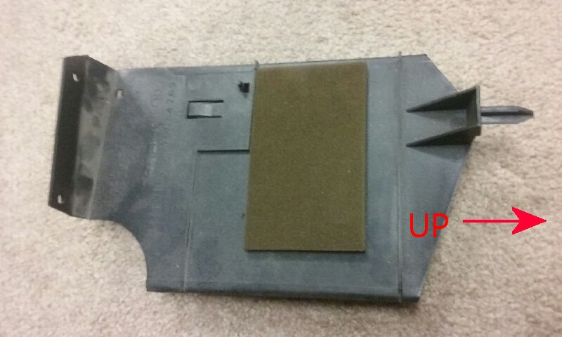

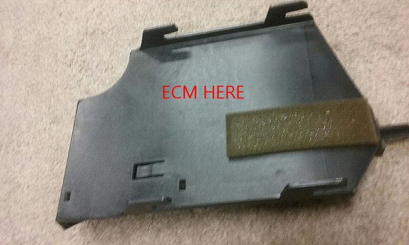

The "bracket" is actually a piece of plastic.
This is out of my '87 'bird. IIRC the one in my old '84 Camaro was white.

Thank you deadbird. I have nothing like that in mine. Time to hit the u-pull-it.
