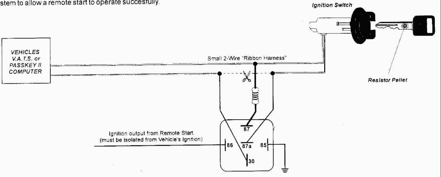

You can use auto start on a car with VATS but you must do 1 of 2 things. Disable VATS totally or buy a VATS bypass which will override VATS while doing a auto start. You can buy them on ebay for $10-15. Here is a link:

What 92RSB4C said will work if you want to override VATS completely. If you want to keep VATS active you will need to buy a VATS bypass.

Here is a schematic.
Oops.Sorry so huge.
