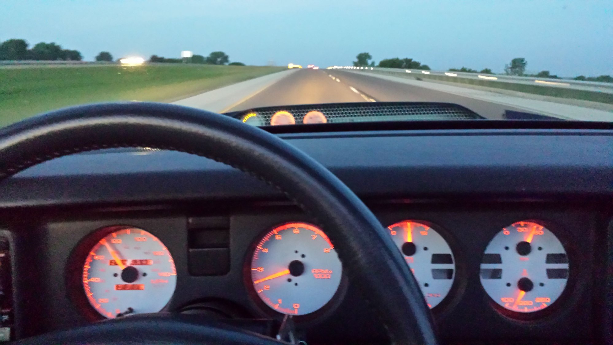

This subject has been brought up before, and I don't believe it was accomplished. I got tired of looking at the blank black space behind the hood and started to look for gauges. It was a tough challenge, the space on the hood opening is only a little over an inch. I finally found a gauge made by the Koso motorcycle gauge company https://kosonorthamerica.com/ that fit perfectly, its only an inch high and water resistant. There are three gauges, one temp for the engine, one for the transmission and a volt meter. The selection for the one inch mini gauges is small. The gauges are only a helf inch thick and are designed to be attached to handle bars with velcro. I JB welded a stud plate and mounted them with two small machine screws.
Tell me what you think?
Louis

Not digital but I put these in my scoop of my 89 in the early 90s. Lights dim with the dash lights.The VHO formulas had some in the late 80s, 87 or so?

Thank you guys for the nice comments. It took me year and a half to figure this out.
Anxious to put it into the car. The only problem that I might have is that the display is not dimmable with the headlights. If its too bright at night, I can put a polarizing filter in front of it. And just as a side note. I will use a filter sandwich with fittings to get the oil temp and go in line with the trans cooler for that temp.
Louis

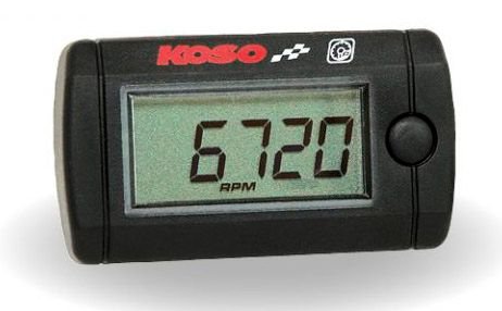

Is there a Tach that would fit in there too? Love the gauge idea!

Hi PMD, yes they do have a tach and its not expensive. The way it works is you wrap the sensor wire around one of your spark plug wires and set it for either 4 - 6 - or 8 cyclinders.
Its just a few mm's larger than as the small gauges that I used, so it will fit.
See here:
https://kosonorthamerica.com/shop/mo...e-mx/mini-rpm/
