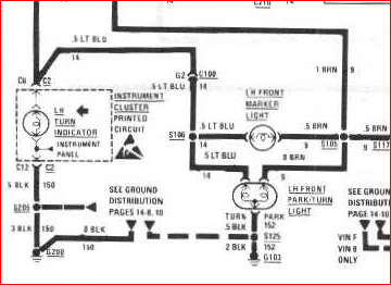

I think there's something else at play like Nina said since an LED IS a diode. '86 I think will be similar to this...
http://www.austinthirdgen.org/mkport...ithout_T61.jpg
The front side markers DO the weird thing using the front signal bulbs as grounds. I have a hard time wrapping my head around that too. My car isn't running, but iirc, the side markers blink opposite of the front signals when park lights are off, but with the front signals when the park lights are on, or vice versa.
*Edit* I'm not great with electrical, but I think I get what's going on... maybe.
When you turn on the park lights, normally, the marker light gets it's ground thru the front turn signal bulb. Since this is now an LED, for whatever reason, it's getting it's ground thru the dash, path of least resistance or something like that.
When you remove that bulb, you remove the path of power.
When you replace that bulb with a stock one, it's still getting it's ground thru the dash instead of a good ground thru the turn signal, so it's dim.
Replace the turn signal bulb with a stock one, now THAT is best the path to ground, so dash turns off.

To add more, just thinking out loud. The current wiring setup requires the side marker to 'flow' both directions, which LEDs can't do.
I'm very interested in the outcome. I'm in a similar boat as you. I replaced nearly all my lights with LEDs, except the side markers, but still haven't been able to test them yet.
So maybe the diode might work. Like you said, before it branches, S106 in the diagram, so you could put it on the engine bay side of C100. Just wonder if that's enough to 'force' the ground to go thru the LED turn signal bulb that is currently failing to act as a ground as Nina said. Before you do that, I'd try turn the side marker LED the other direction and see what happens. I'm guessing it will fix the issue with the dash, but won' t come on with park lights.

So looking at the wiring diagram, when the parking lights are on power is fed to the side marker and front park/turn bulbs on the brown wire, and the light/dark blue wires are used as a ground for the side markers through the front bulbs. The LED bulbs will not allow that to happen.
The solution here then is to add relays wired to ground the light/dark blue wire when power isn't applied to that wire. That would be wired terminal 86 to light/dark blue from turn signal switch, 85 and 87a to ground, 87 and 30 to light/dark blue wire going to side marker bulb? Does that sound like it would do what the incandescent bulb does. I had to do a similar thing with the wire for the cruise control off the brake switch since I am using the Digi-Tails.
It appears that it works the opposite way when the turn signals are on with the side marker grounded through the front bulb. Am I going to need a relay on that circuit as well?

Attachment 453467
The answer to my last question is, yes, you do need a relay on the turn signal side as well. It appears to work fine with the LED bulbs, but if you put an incandescent in the side marker and turn on the turn signal it lights so faintly that you can barely see it. Apparently the LED's draw so little current that whatever ground they can get is sufficient, but not enough for a regular bulb, so to be safe you need to add a relay on that side of the side marker too. Will try this when I round up some weatherproof relays and see if it fixes the problem. Wiring would be the same except change light/dark blue to brown in the wiring instructions for the relay I described above.

I think I'm on the right track, but had the wiring slightly off above. You actually want to connect 86 and 87 to the wire coming from the switch, 85 and 87a to ground, and 30 to the bulb. If you do this the indicators don't come on when you turn on the lights, however, after you use the turn signal once, the indicator stays on solid until you turn the lights off. Turn them back on and no indicators until you use them again.
If you connect 87 directly to a 12V source this does not happen, however, the relays click loudly when you turn on the turn signal.
I think I'm going to try connecting 87 back to 86, but with a diode to prevent current from flowing back to 86 and the turn signal circuit. That really shouldn't be possible with 87 switched off by the relay, but apparently not? This is really weird.

Went back and tested the circuit after turning off the turn signal, and somehow it has about 4V bleeding back up the wire to terminal 30, then across to 87 which when connected to 86 allows it to get back to the indicators and apparently also trigger the relay so it never switches back to 87a to ground the circuit properly.
I'm going to assume that if I add a diode the relay is going to switch properly, and the click will come back, so might as well save the money on the diode and just wire 87 directly to the battery. It only clicks when the turn signal is on, the clicking of course being the switch inside the relay operating.
If you have this issue and want to use the LED's, connect 86 to the wire coming from the switch, 87 to a 12V source, 85 and 87a to ground, and 30 to the wire going to the bulb. You will need 2 relays on each side marker light, one on each wire as described.

The problem here is the circuit grounds through the unused filament in the park/turn signal bulb in the front bumper. When you replace the 1157 bulbs with LED's they don't ground properly and ground through the turn signal indicators in the dash when you turn on the lights causing them to stay on solid.
The relays I added ground the side markers properly so you don't get current running back through the indicators.

It's already fixed. The side markers ground through the front running light bulbs, and when you put LED's in that location they don't allow that to happen, so they wind up grounding through the turn signal switch causing the indicator light on the dash to come on. Wire a couple of relays as I described above, and the problem is solved. Or just don't use LED's in the front running lights...

Yes 83 Crossfire TA, it is because of those dual filament bulbs.
