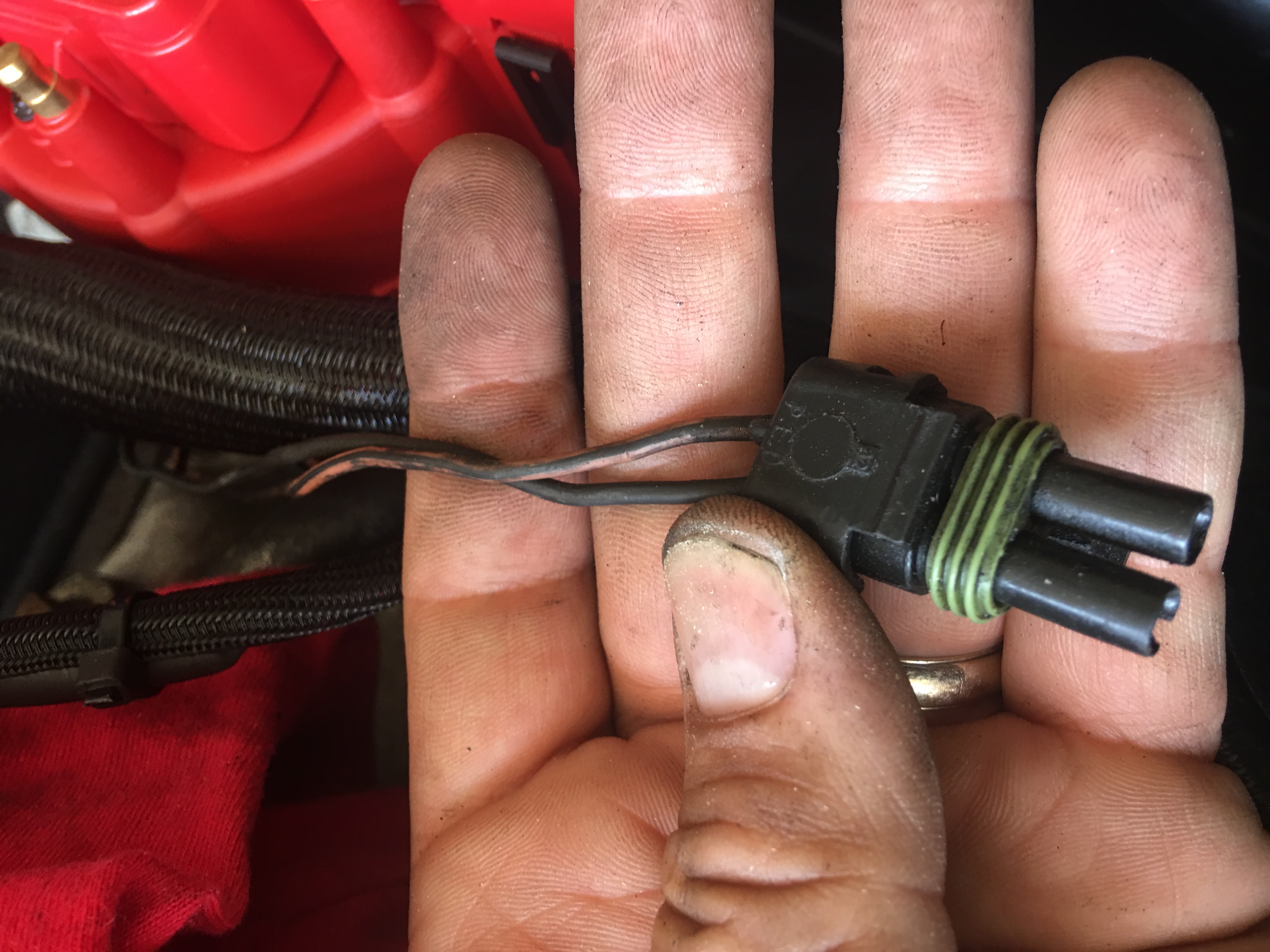

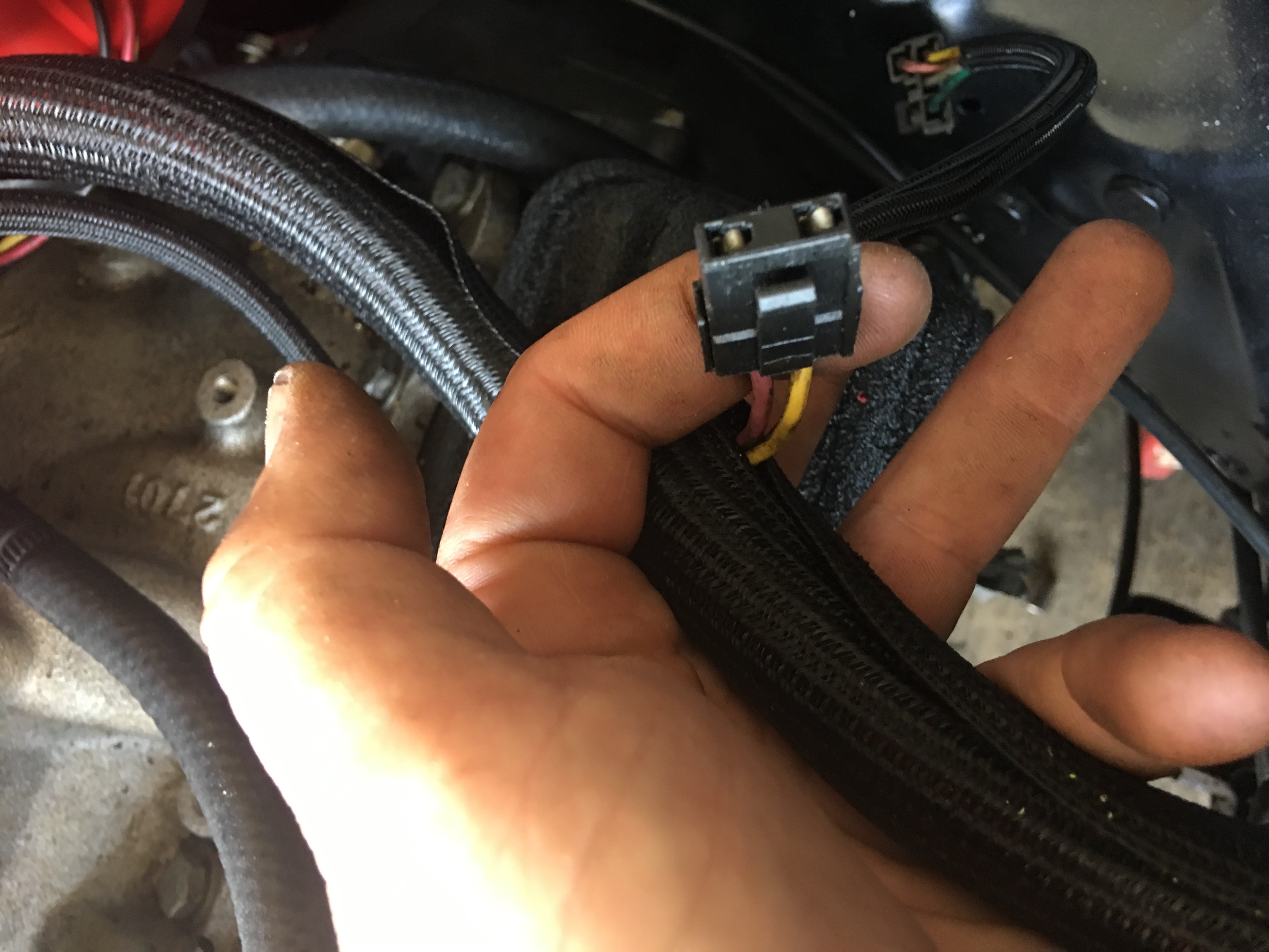

Guys, trying to identify the last two plugs on my 87 z. Not sure where they belong. Thanks in advance.

How about Wiper motor, and EGR solenoid maybe? The second one might be the Mystery plug that 87's have that is never connected to anything. The seal looks pretty dirty for something that was plugged in.

It’s not the wiper motor. I have that one. It has multiple wires. To be more specific the TPI wiring is removed and only the body harness remains.

I don't know, maybe I'm mistaken. Purple and Yellow in that plug goes to the wiper motor. It has two different plug-ins btw. Pink/Black and Gray are EGR solenoid. Anyway, goodluck with that.

My apologies, I looked at my wiper motor again and you’re correct, both those plugs are for the wiper motor/washer.
