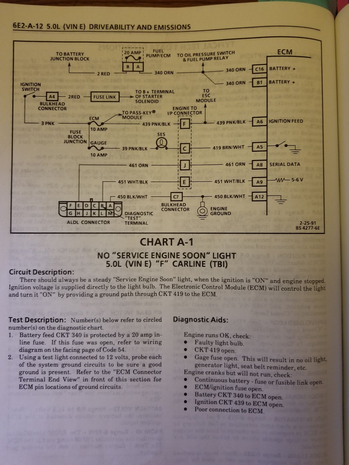

sorry! I never saw this post!😂 Guess it came in while I was working on a post.

Re: Big trouble

Thank you very much. Another question. Where are ckt 340 and 439? I have a sheet list of connectors from c00 to s218.: tells me location and how many cavities. These are not on the list. I wish I could get a service manual. Anyone take checks anymore?

CKT340 = Orange Wire - Pins C16 & B1 of ECM (Battery 12V)
CKT439 = Pink/Blk Wire - Pin A6 of ECM (Ignition Feed)

Power to both 340 wire. 439 nothing. Just wondering. I had the ECM disconnected from the harness in one test and no lights on or ignition switch. When I started to connect the ground to the battery there's a small spark like there's something on in the car. Is this normal?

Switch looks a little fried. By the way, the two 340 pins had 12v even with key off.
Old Apr 18, 2019 | 05:52 PM
92RS-HeritageEd's Avatar
Joined: May 2015
Posts: 674
Likes: 23
From: Ohio
Car: 92 RS / 90 IROC-Z
Engine: 305 / 350
Axle/Gears: Non-Posi / Posi - Both GU2 - 2.73
Re: Big trouble
Those two are battery constant my friend...

I ground to body and tested with only the very low reading.. I'm going to replace the switch now anyway..them two hot wires come off the fuse box? If they do, which fuses? I will look over the previous post for the answer Incase I missed the answer. I do have power to the engine side of firewall c100 on a4 pin. Right side of box hot. Lights and such. I think I have a fried in 2 wire or two. Looks like dash is coming out next.

Update. First I would like to thank all for your help. I put a lot of time in and parts I've had laying around. The problem was that one of the previous owner had taken a major fuse out and burned out the ignition switch. I changed engine harness. Steering column from non tilt to tilt. I had a good switch for it and I like them better to. Checked the dash wiring out and installed it into a dash out of a 86 Camaro that was factory a/c. Changed the heater box while dash was out. It started!!😊
