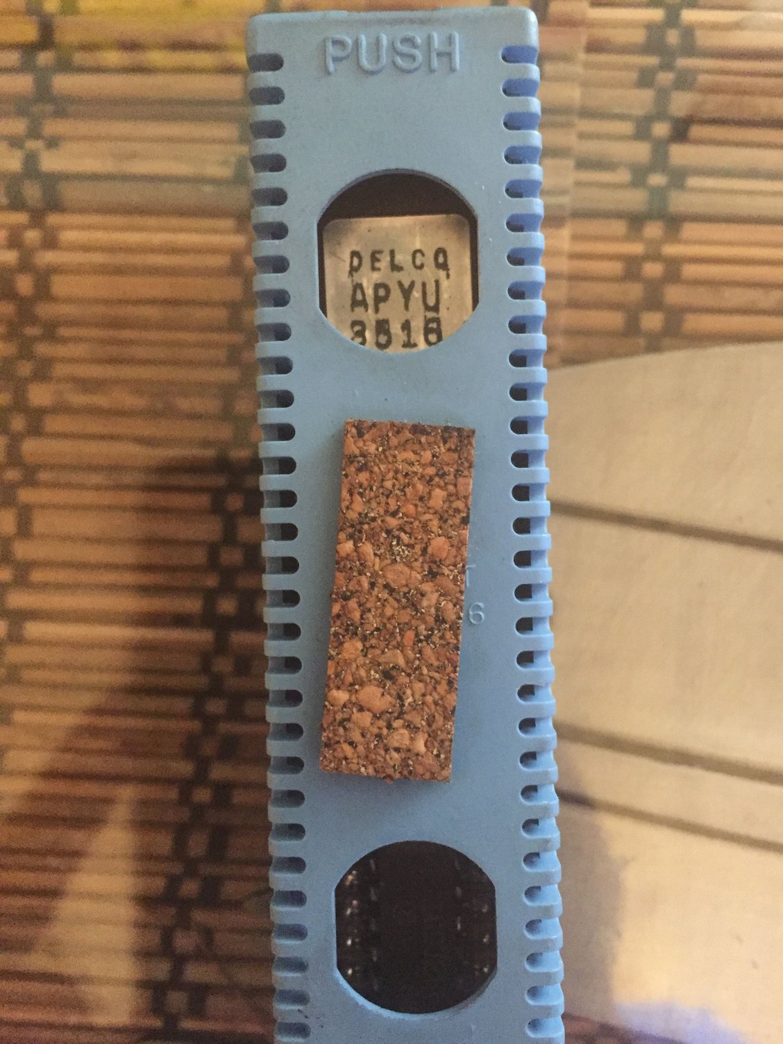

If you provide the code off your memcal (4 letters). I can see if I have that file.
If you wanted to mail me your memcal and pay return shipping I can check it out if I have the file to see if it’s corrupt.
The silver sticker on the memcal should start with the letter A

I have a 165 ecm . Ecm for 86-89 tpi.
Confused about your service numbers and that’s it’s a rs.
I will sell you. As for the memcal let me know the letters off of it and I can get one together as well. Or if you want to mail me yours I’m sure I can refurbish it.

software $6Ebin from 1989 Camaro; Is this what you need?

Is that what the prom says ?

That's what I was given, when that engine was installed. Programming is above my pay grade.

Re: O2 heating time?
The four letters identify the programming you have.
without knowing this I have no idea what’s needed.
