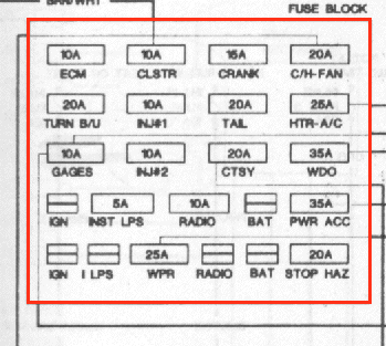

FIRST...Check fuse #11 CTSY
Thats the fuse for those non workin accys.
Test for power there.
1-2-3-4
5-6-7-8
9-10-11-12
13-14-15
16-17

YES!
(on a 84 but yours should be the same)
#11 20 amp fuse powers
courtesy lamps, dome lamp, rear comp. lamp, clock, horn,
cig lighter, hatch release, power ant.
I would start there first with my test light!
