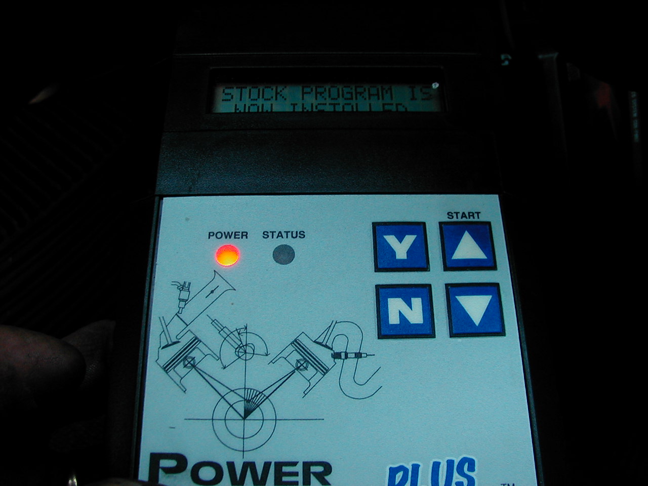

My 95Z has a rev limiter and I just can't remember what the stock rev limit was set @ !!! You can adjust it with a Hypertech Power Programmer or some similar "programmer". Mine reached about 142 when it had 3.42's; I ran out of road and just never took it that high again. ( Might be willing to sell the Hypertech,................ I've already returned my Z to the STOCK config so the HPP is ready to use. )
