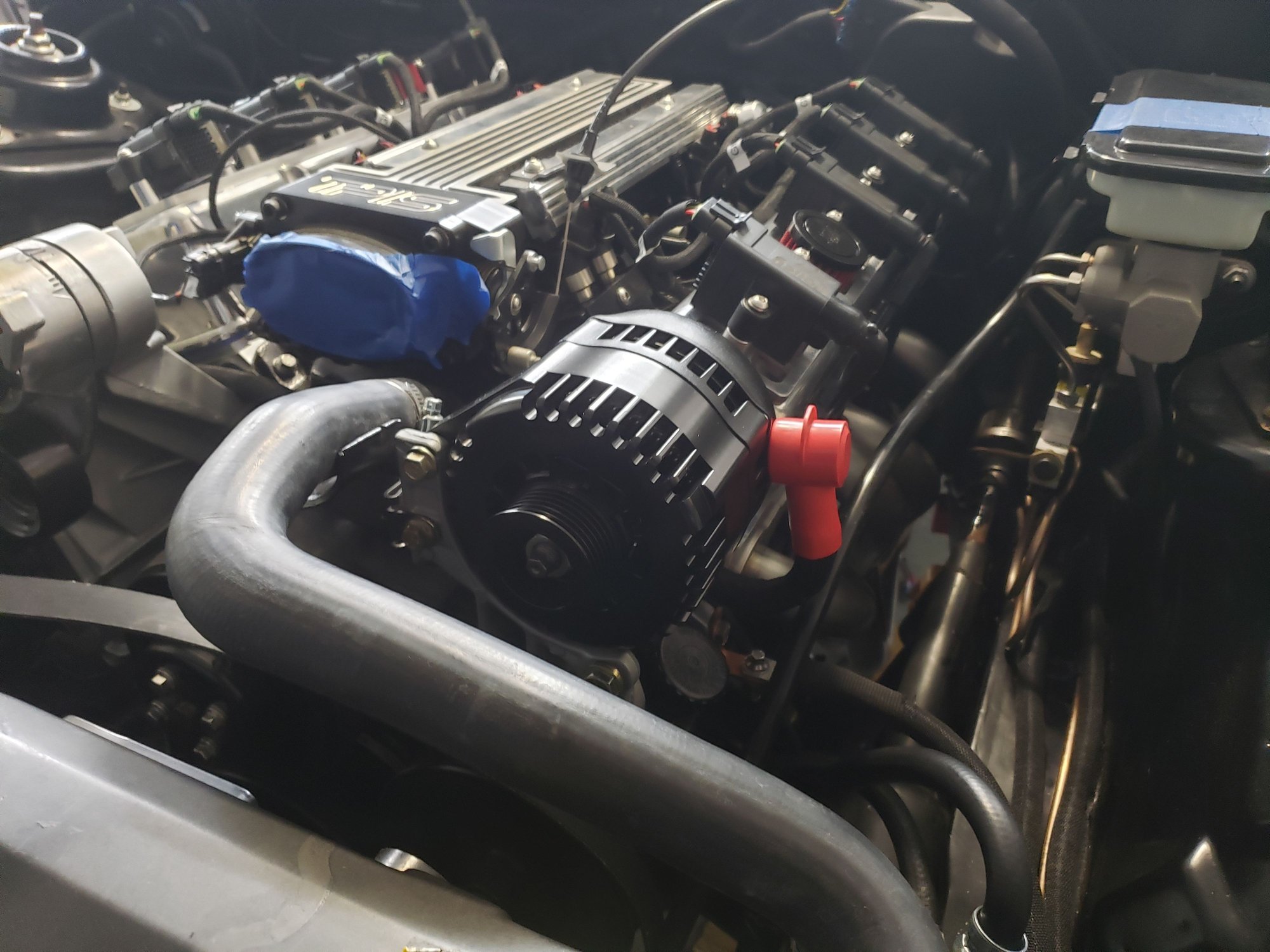

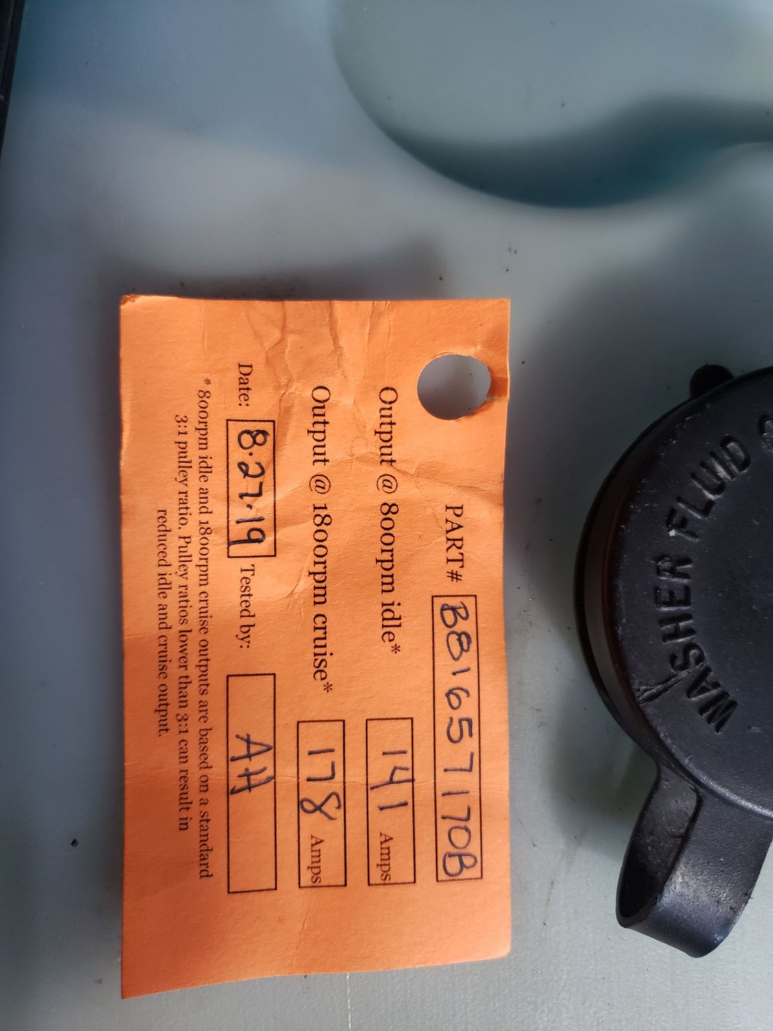

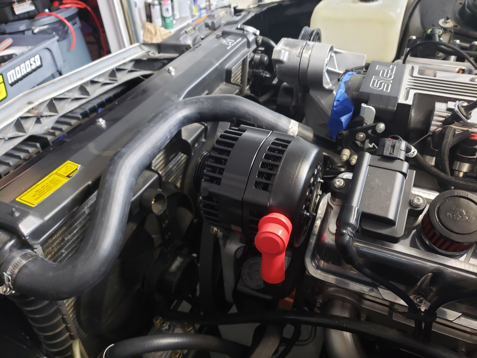

Just got my mechman alt. Big difference in idle amps vs stock. For those with big systems or what not.
Built specifically for mu combo. Only a street car but bigger pump,cnp big wire, electric trans, etc. Disnt want to be at the limit so how I have plenty of breathing room. It's a one wire. But they make one with factory plug in.
