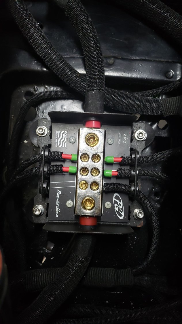

Re: Tech Advice on wiring up relocate battery and kill switch ?
Just to clarify, that was my main power distribution. 2 of those circuits go to the stock fuse panel for everything chassis. 1 circuit went to my add-on underhood power center for everything that has to do with the engine. 1 circuit powers the original HVAC high speed fan. And the 4th circuit I don't remember, LOL! (maybe it's my Boost-A-Pump).

Basically the Battery postive line will go to a positive jump-post in the engine bay. one wire will go directly to the starter. the other wire will go to a 150(??)amp in line circuit breaker, and then it will go to the power distribution block for all things engine and chassis that require a positive power lead.
I was thinking this for the distribution block because it has several large and several small screw terminals to use. thoughts? https://12voltconnection.com/product...busbar-3-8-red
And for the circuit breaker (instead of an ANL fuse) I was thinking this: https://www.summitracing.com/parts/s...iABEgKcxvD_BwE
artic: thanks, I now understand that the entirety of the kill switch body will be outside of the sheetmetal. I had assumed it would protrude into the body a bit deeper, so I was concerned about the accessibility of the 4 posts on the back of it. Glad to know it will be less complicated than I thought. I am also glad I paid the extra $ for the weatherproof option on the kill switch
scooter: yup, I was pretty sure that my 1 gauge wire was 1 gauge. I knew it was not 0 or 1/0 because the 1 gauge terminals that I crimped on the ends went on perfectly snug. it was $2.40 a foot, but i got it locally so I avoided shipping costs
Iroc1989: cool. I have never heard of the electrical ferrules, but I searched it and those do look really cool and certainly better than just cranking down on stranded wire ends. nice! I will look into ANL fuses a bit, but I am thinking I might be better off with a re-settable circuit breaker just like I put in the alternator line. I put a 200 amp in that line, but I am thinking I can do a 150 amp one up front.

ah, damn!! I wish I had read that earlier! I just ordered a 150 amp circuit breaker and the bus-bar/distribution block a little while ago.
and
I don't think I'll be using the black "ground" one, but I might decide to. unsure if I want all grounds going to it, or If I will just run grounds elsewhere nearby each component that needs a ground. I might use the block though, . I'll have to see how much space I have in the old battery tray area and how I can lay things out; neatly, spaced apart, and safely.
thanks for the help everyone. keep the comments, suggestions, and advice coming. This is my first time doing this, and I want it to be done correctly.
and

ok cool. thanks guys. if I am unhappy with the circuit breaker and junction block that arrives on Friday, I'll return them..and order from the places you and Scooter suggested.
My Longacre 4 terminal switch arrived and I had some time to install it to test my wiring. it is not 100% fully installed, as I want to neaten up the wires, mount some wires better, and basically get everything cleaned up and put in place properly and securely. But, the switch (and my wiring) works!! car fires up, and when I flip the switch off, it kills everything instantly. AWESOME
and a video
https://www.youtube.com/watch?v=3y9kT-HgKb8
https://youtu.be/3y9kT-HgKb8
next, I'll probably drive the car around a little bit just to enjoy a running engine for a few more miles. then, I'll switch focus to the engine bay, and begin removing what needs to come out.

switch works great. a very solid click when turned on/off. I tested voltage at many connection points and terminals. battery itself was 12.33 volts. I got pretty mucht hat same exact number at every connection point...even up in the engine bay at the jump-post, I got 12.32 volts.
Project complete
