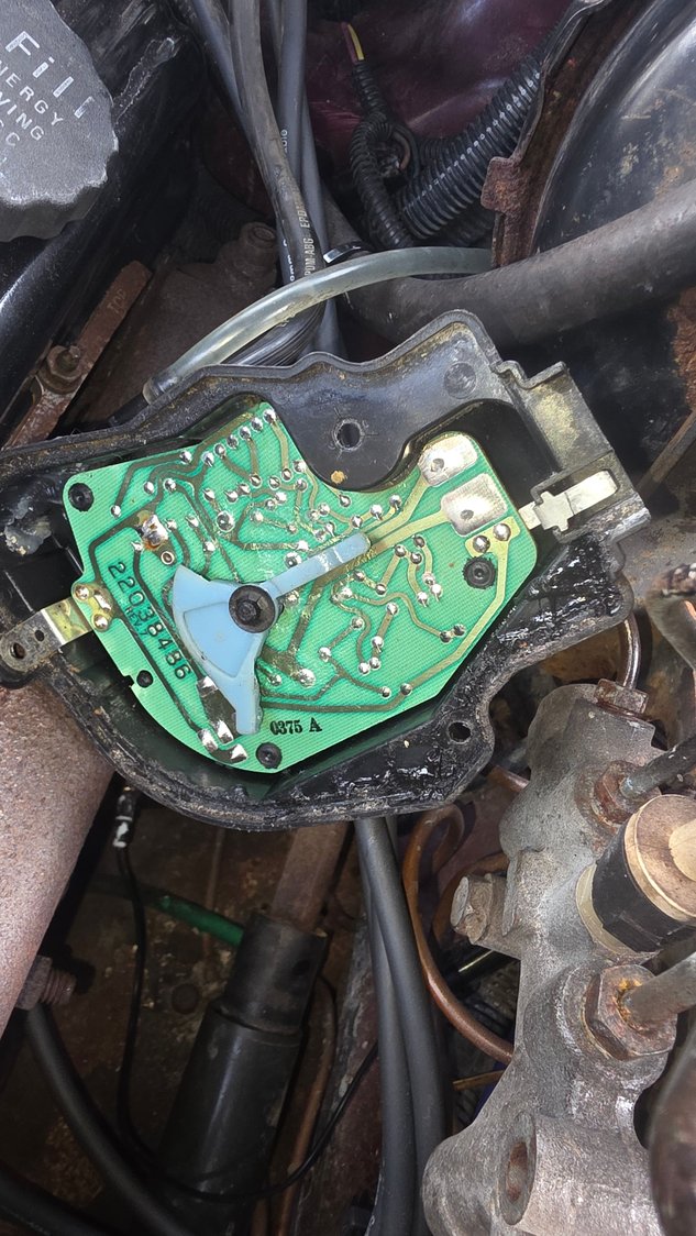

i found my issue to be the (blue) armature on the wiper module was not contacting the switch:
I assume this means the module never saw the wiper rotate, which is what caused the motor to run endlessly.
i reseated the module and now the wipers are operating as expected.
I’ll still need to replace the switch as it rotates too far, but at least now I know it’s meant to be a delay wiper setup.

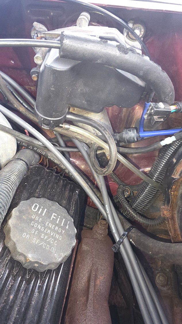

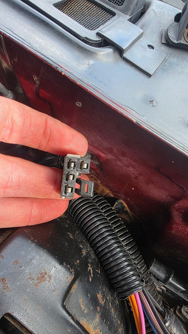

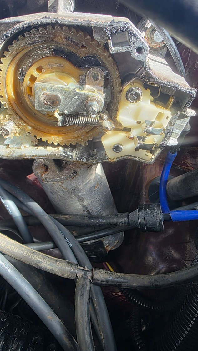

I have a similar issue, mine being the 85 trans am. The wipers only work on fast now but don't even sweep, the washer pump has also stopped working, and none of the settings on the wiper stalk for the wipers work only the fast setting, plus the crank doesn't move with the motor spindle.
I can't add the short video of the motor and crank arm as it is mp4 not mp3
