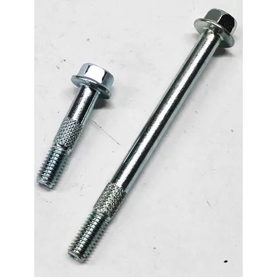

they’re the ones that were on the car when i first got it, i’m pretty sure they are starter bolts, i don’t know the difference though so someone please enlighten me, i’m going to jack up the car today and take the bolts off, i’ll post pictures when i get them off

Real starter bolts have a section right behind the threads that's larger. The block has a larger dia hole at the entry, with the threads starting at some add'l depth down in there. The large section of the bolts makes a kind of "dowel pin" arrangement, to positively locate the starter, and keep it from loosening the bolts.
The 1st 2 classic symptoms of using the wrong bolts are, the starter misaligns itself and grinds; and the bolts back off and get loose. The 3rd classic symptom is when the gorilla comes along and strips the threads by tightening them to try to get it to quit doing the 1st 2.
You can get the right bolts in the Help! section of misc hardware at the corner parts store.

FYI:
Starter bolts
Note the sort of "knurled" section right behind the threads. That's what makes em special.
And the holes they go into

thanks for the pictures! i bought a new set of starter bolts but all of them are long bolts, and the bolts i took out of the old starter are both long as well, am i making the same mistake as the previous owner? i’ve been running some experiments and it seems that one of my bolts keeps backing out only after i take it for a drive, i’m thinking either my bolt hole for my starter might be stripped because the bolt that was in it before wasn’t a starter bolt, or, my motor mounts are knocking it out, since they are very worn out, or a combination of the two. appreciate your help!
