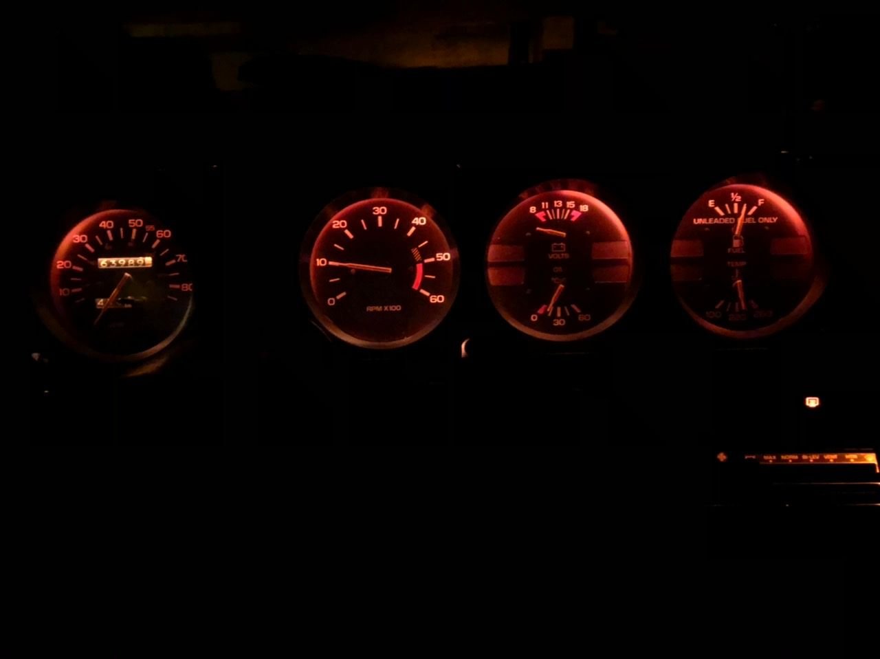

For reference - here’s a picture of my gauges
