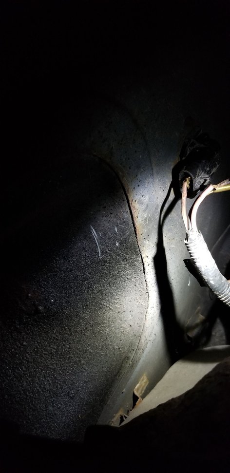

Long story short my fuel gauge has never worked (pegged just past full), always assumed the sending unit was bad. Today after some reading I went to verify if the gauge actually works. That's when I discovered the plug that goes into the back seat to pass through was "rigged" back together and covered in electrical tape. Notice there is no female connector, the wires were just jammed in. I verified my gauge works using a paper clip watching my gauge go to empty. What I want to know is where I can find a connector to splice in, and where I can find a pinout of that connector so I wire it correctly while I'm under the car. As in, which pin is the ground, the signal (pink) and so on. Factory wiring diagrams don't show this connector as far as I found (I have the factory technicians manual).

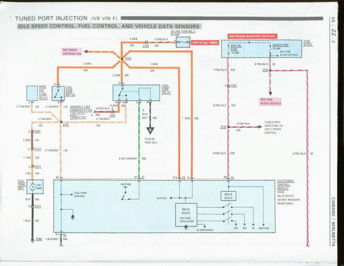

That connection/ or Connector is The C313 Electrical-Connector:
-Terminal "A" has a 16 AWG Black Wire, and is the 12V- (Ground) Connection.
-Terminal "B" has a 16 AWG Pink Wire, and is connecting the Fuel-Tank Float to the Fuel-Level Gauge.
-Terminal "C" has a 16 AWG Tan Wire, and is the 12V+ (Switched Power) Connection to power the Electric Fuel-Pump.
Below are two Schematics that show the C313 Electrical-Connector, and the Circuits that go through it:
The Connector that is missing, is available in Parts, to build yourself...
But I have NOT seen a Pigtail available for a long time.
You could try and purchase a used Pigtail from Members here, Forum Sponsors, or a Junk-Yard.
If you own the correct Delphi Terminal-Crimpers, let me know and I will Post the Part-Numbers...
so you can build a Connector for yourself.
Good luck!
