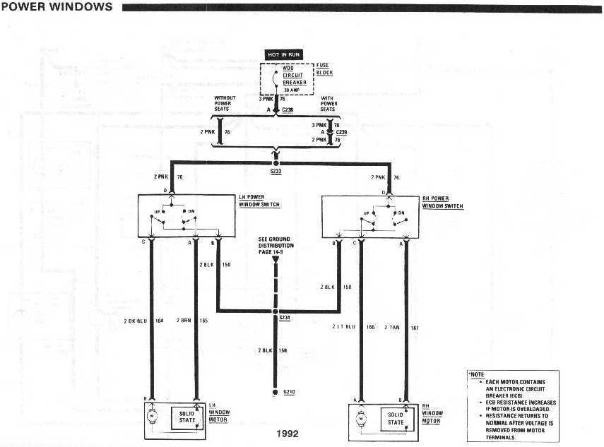

I do not know what year your F-Body is (hopefully its a 3rd-Gen... actually, I hope its an F-Body)...
But here is what the Power-Window Circuit looks like:
Just as 84_1LE said: There were no Fuses used in the Stock Circuit.
Please let us know some details to better be of some help to you.
