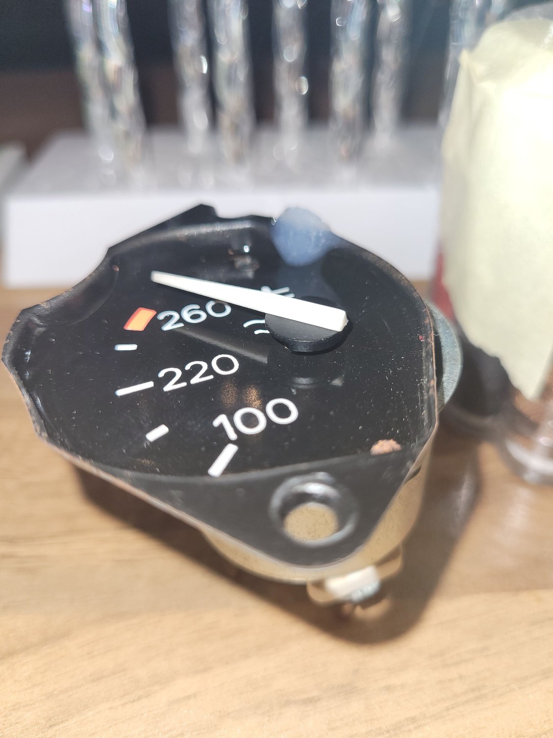

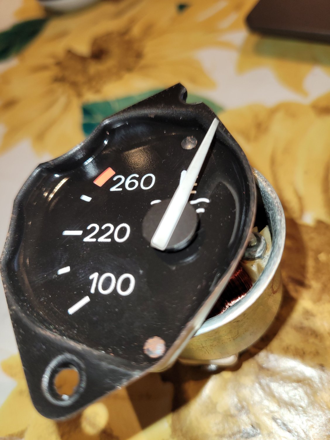

I have pulled the gauge, but am scratching my head how to fix it.
Is this a known problem ? Maybe just wear in the gauge making the needle jump over the edge and get stuck.....

Looks like the stop pin is broken off, letting the pointer get up farther than it's supposed to.
Ahhh.....so there should be a stop pin...that explains it.....

I don't know if this will last, but at least I will try this as a start and then if it doesn't I will order a new gauge.
I glued some epoxy to the part of the gauge where the needle hits the edge and it works so far....
