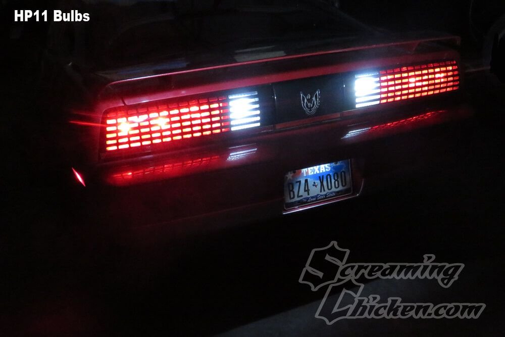

We have several different kits, including all the lights in the tail light housing or just a pair of bulbs. We have tested the parts on 3rd gens and include instructions. We are also located in the DFW area and can do the install for you. We also have a 3rd gen car show at our location the 3rd Saturday in August every year (August 20th for 2022). We also have free prizes and food at the event.

Complete led exterior lighting kit now available.
1991-92 Firebird Complete LED Exterior Lighting Kit (screamingchicken.com)
