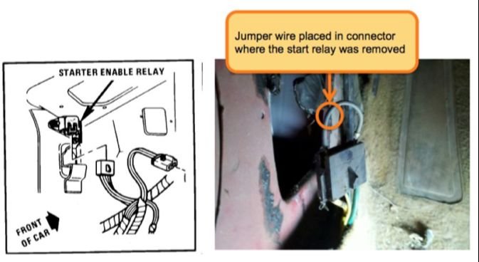

Hi can anyone tell me if my 88 GTA Firebird has a starter or solinoid relay and if so where is it, i am told by a Pontiac guy i does not have a starter relay?

If you have a chip in your ignition key it has a starter enable relay under the drivers side kick panel.
Thanks for that.
I partially removed the kick plate but cant see too much.
Where could i get one or see a picture of one?
The Ponti dealer in Australia here still says they dont have one?
Thanks so much for your help.

or bypass

The local Ponti guy here said if i have a chip in the key, which it does , then its a 1989, not 88.
I removed the kickplate and found a small metal component with 2 plugs coming out?
What you think and can anyone post a pic jf they have similar?
Thanks so much.

https://www.thirdgen.org/forums/tech...-did-they.html

Sounds like its the starter enable relay.

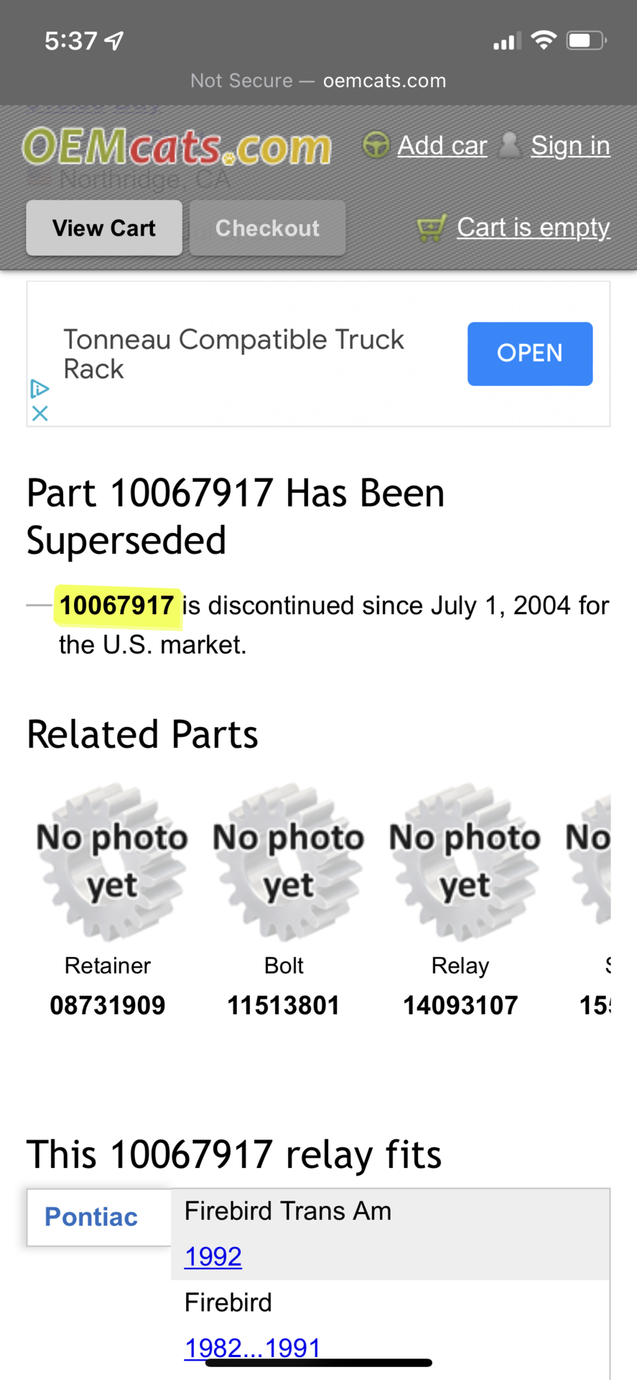

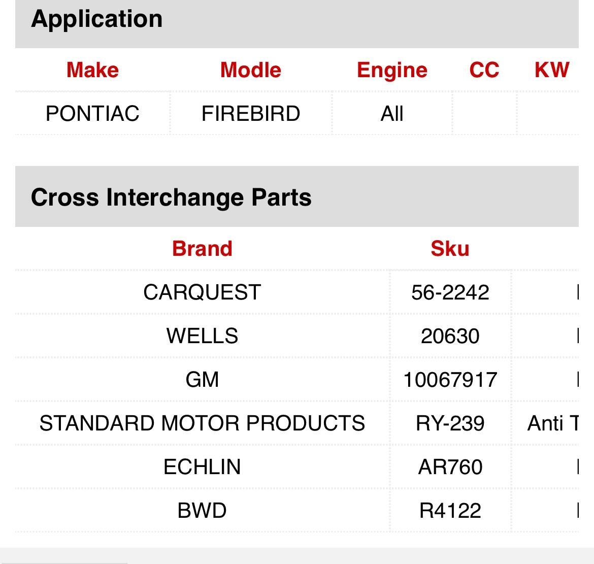

Can anyone send me the GM part no for the Starter Enable Relay., this seems to be what i need.

that was covered in post 4 it’s nla

Hi there ,
Thanks for that but i need the part no as i m not in USA.
Would appreciate where to get it or a contact?
Thanks.

Nla , just bypass or post in classified section wanted good used. Or rewire to spdt relay and plug.

It looks like the starter relay will have to by passed.
Will this be ok and not cause any other damage?
