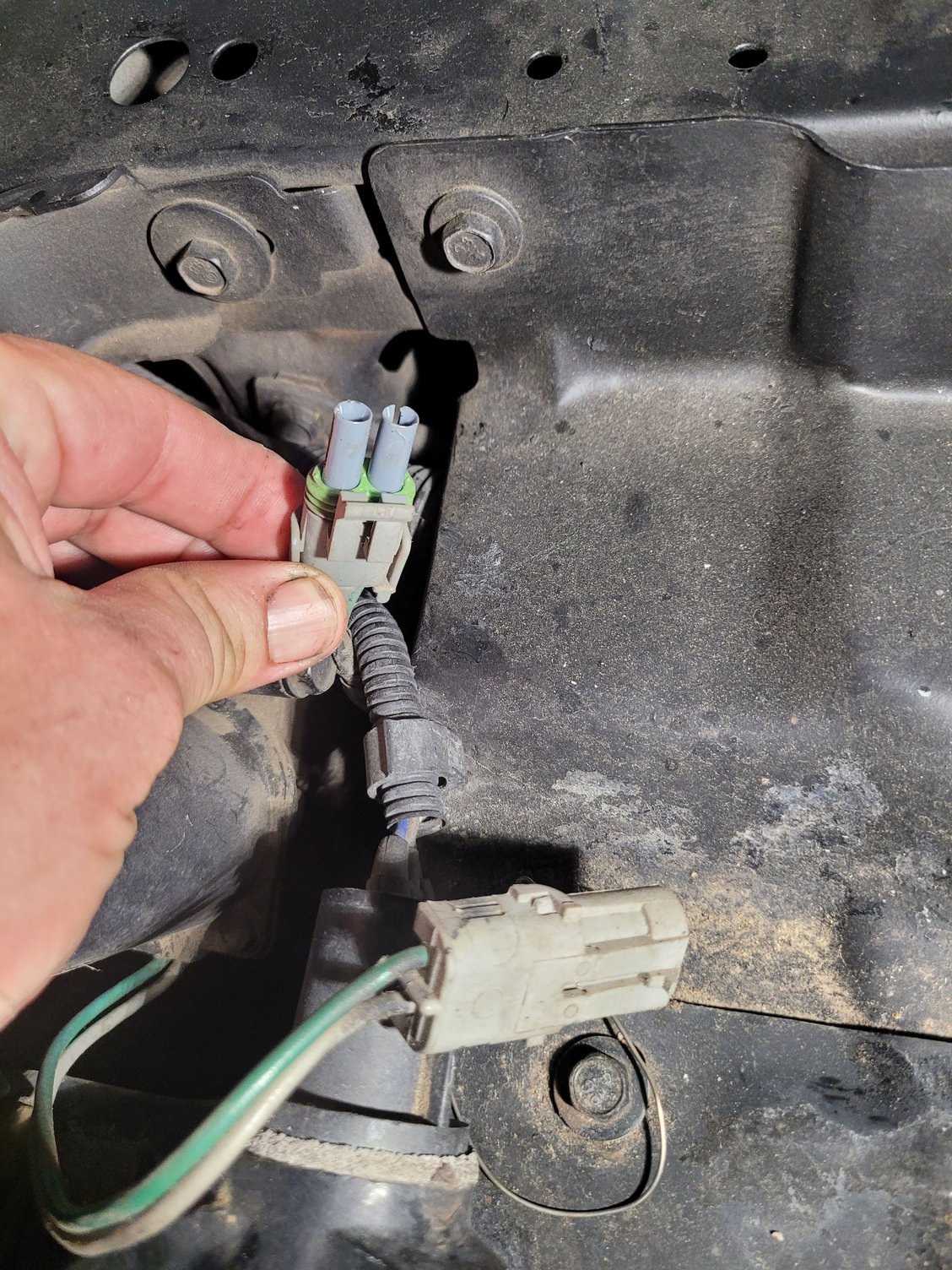

Hi, What is this and where does it plug in. I pulled it accidentally by feel reaching up in front of wheel hub into passenger side headlight area. Was meaning to disconnect Intake Air Temp sensor but couldn't get hood open. Thanks.

Maybe the headlight motor connector?

Lol, the ability to open the hood was already an issue. It sticks but i can usually do the tap tap thing on it and get it to release. I was unplugging the IAT because I have been broke and playing "sensor tune" 😳😳. I have been having serious driveability issues a nd it runs way better with stuff unplugged. I am far from a mechanic but I have read/learned enough from thousands of hours on here, my Haynes manual and knowing my car after 9 years to narrow things down (yeah yeah, I'm a Google mechanic lol). So maybe you guys can help 🙏. That plug isn't my main concern. What's going on is power loss and backfiring on acceleration, hard starts but it does always start after 15 ish tries, idles great after that, random stalls at lights and turns but starts right back up. I have a cheap plug in code reader. At first it just had a code 44. I, and some others who have witnessed the cars behavior, were thinking fuel pump but it primes and I think would be complete toast by now if that was the real issue. I am thinking more electrical short or bad ground. It now gives codes 13, 23, 33, 34, 44. It's like it's running in open loop or limp mode when it gets up to operating temperature. Oh, it is a 91 V6 3,1 Firebird with aftermarket intake and exhaust. I live in the California desert and it typically is around 115 during the daytime right now and my car hates it. The car will "catch" and suddenly surge after getting past the no power misfire thing. A couple other things to note are speedo and odom quit like a year ago, oil pressure gauge has always read between 60 and 80. Right now I have MAP, O2 sensor, IAT unplugged bcuz itt runs way better without them. Thanks for any input. Obviously, I know I should take it to a shop.

Headlight is pligged in but thanks for the suggestion. I actually fixed that headlight myself with Top Down Solutions repair kit.

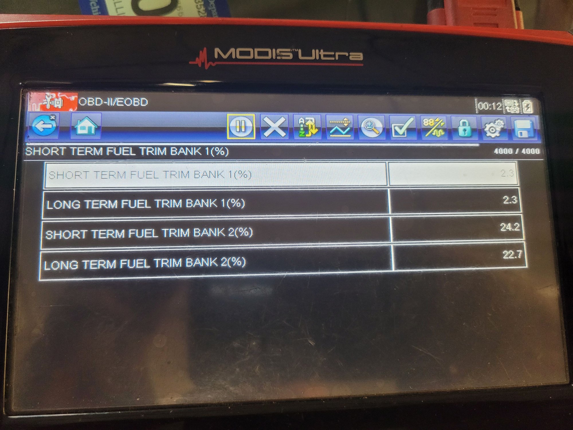

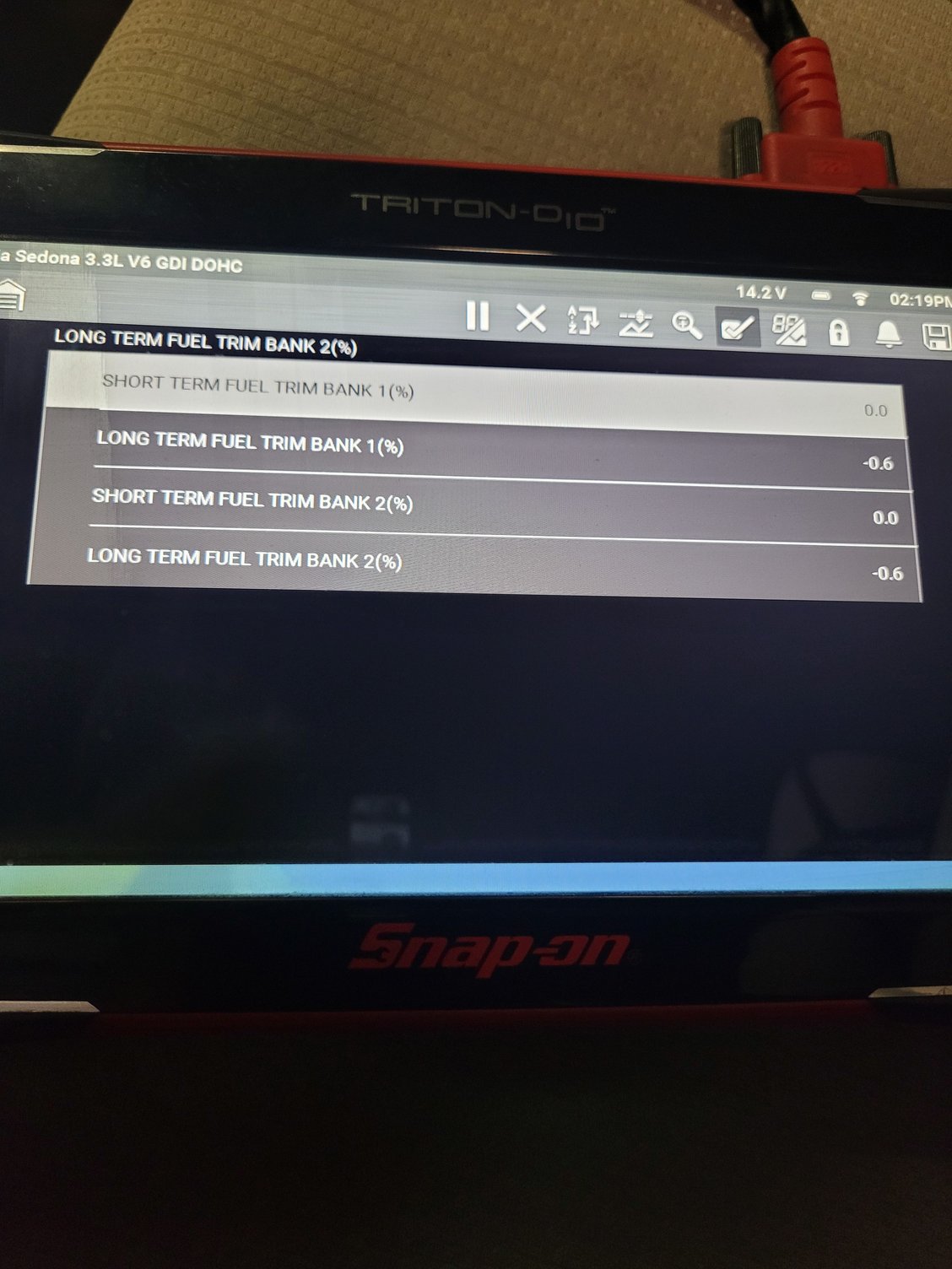

this is a good side by side example related to what your car is doing. Bank 1 is within its +/- 5 percent range of adjustment, where bank 2 is way beyond that range so it set a code for bank 2 system lean. This is looking at correction percentage, with it being a positive number the pcm is adding more fuel to that bank to try and correct the air fuel ratio just for that bank. The front o2 sensors read the amount of oxygen in exhaust and the pcm determines based off of that info does it need to add or take away fuel.
Obviously you can't see percentage of correction with your pcm because of lack of equipment but at least you can have a better idea of what's happening to your engine.
your computer is telling your injectors to give the engine more fuel , so if fuel pressure is low they can't give it enough to keep up, but also if the o2 sensor is bad then it will be telling the pcm false readings and the pcm will be compensating for something it shouldn't be. Coolant temp sensors will do that too. If it's 100 degrees outside and the coolant temp sensor says it's -40 then the pcm will be adding a lot of fuel that it doesn't need.
