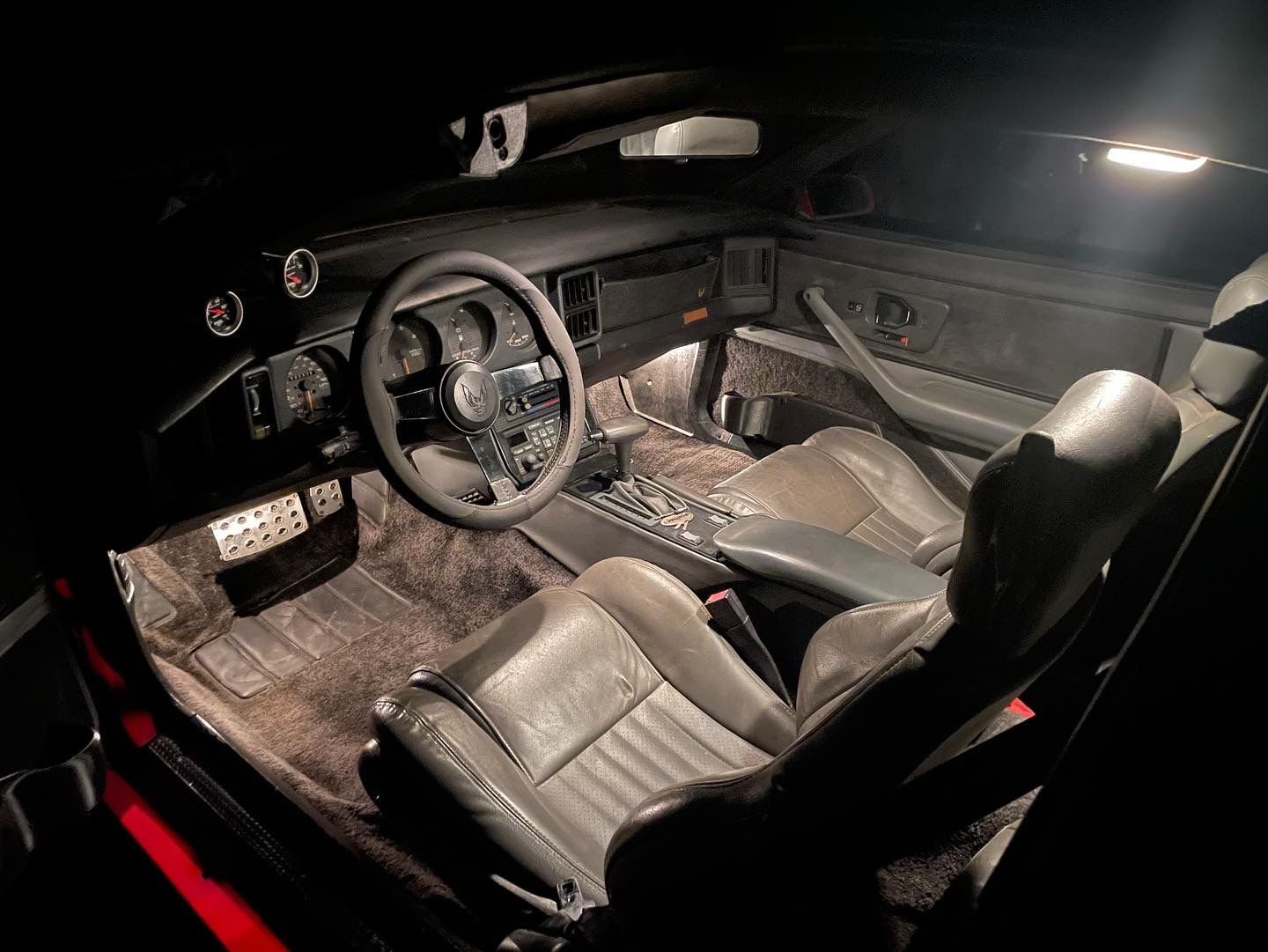

My 91 Firebird didn’t come with these and I wanted to them. I used a couple of these tail light bulb sockets as their about the same shape as the notched holes in the hush panels under the dash, I used some 192 bulbs. I used a Add a fuse fuse holder to get them power. If you have a little wiring experience it’s not vet difficult, if you don’t that kit that was posted seems to be a easier way to add the lighting.

The footwell lighting kit from Screaming Chicken seem like a good option.
I used a Add-A-Fuse fuse tap plugged into the ACC fuse to power the footwell lights that I added. The ACC fuse is what powers the dome light.

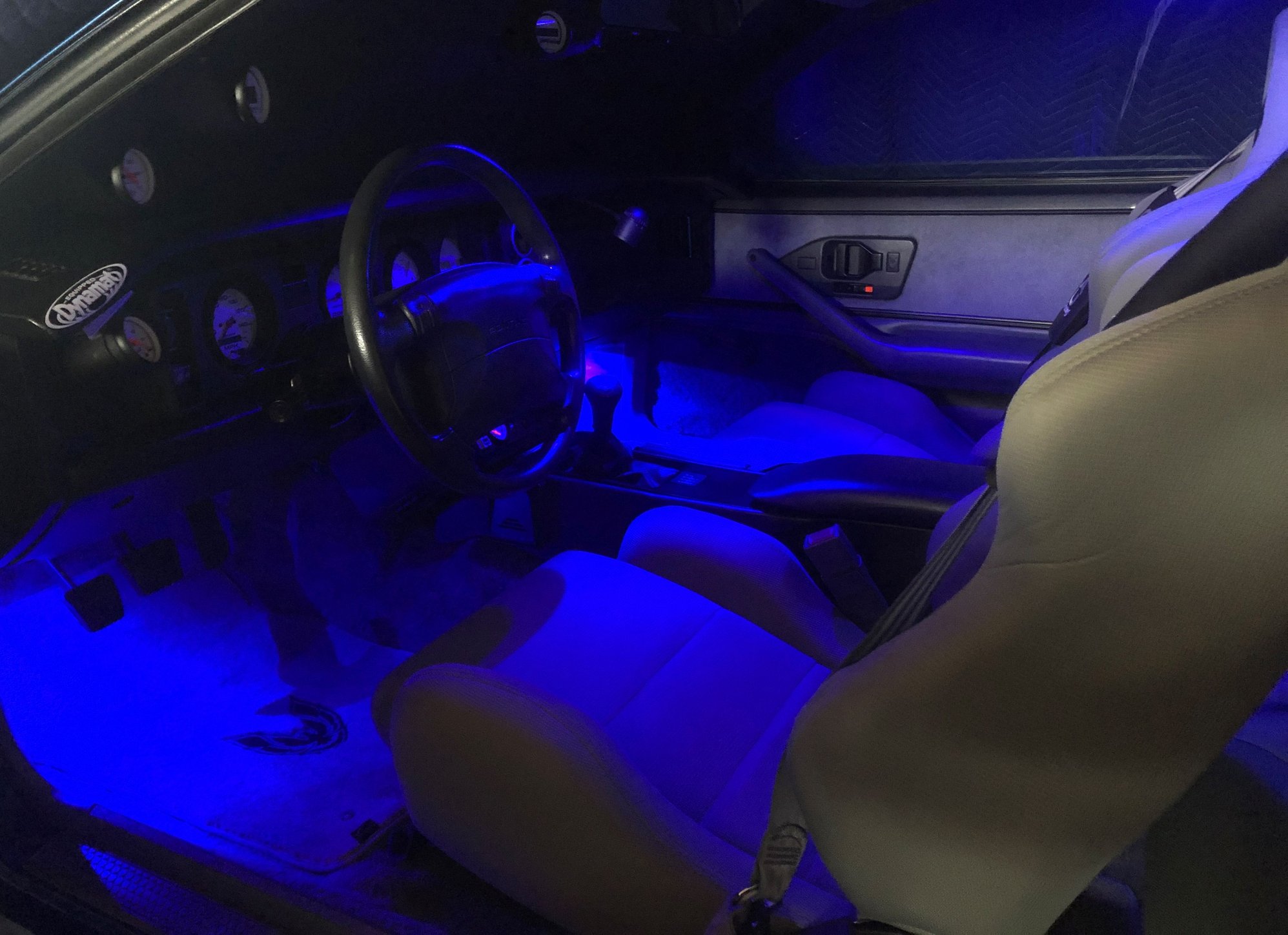

I used the same connectors as @91Bandit2 and some blue led from amazon (Keiurot, blue LED lights, #194). Passenger side fits in hush panel OEM hole, driver's side was a bit tricker. It was custom fit .
But for the life of me, I can't remember how I connected them. I think I hooked them up to the OEM connectors. Definitely controlled by dash switch and door switch, so it is hooked on 20A Tail Light and 5A Inst LPS, but how... can't remember!
