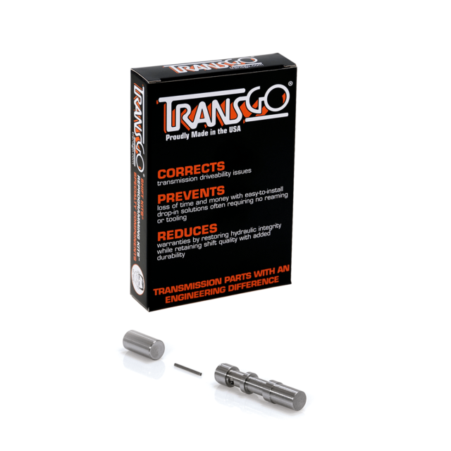

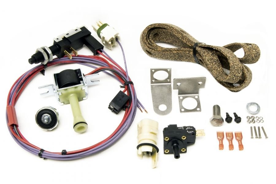

You are going to want to keep using the Torque Converter Lock-Up.
You will overheat and prematurely cause the THM700-R4 unless...
The Transmission is modified (TCC Apply Valve from TransGo), or a Non-Lock-Up TC is used.
The Lock-Up feature is electrically operated and does not require any electronics or computer module.
Vacuum Switch, Brake Pedal Switch, Electric TCC Kits are available to keep Lock-Up.
If you are not savvy with Our Vehicles yet, I recommend the Kit in the Hyperlink below:
Try purchasing this through Summit Racing (or where ever the best deal is):

ok cool that’s actually the kit I was getting I just didn’t know if it was a turn it on when the cars on and it does all the work or if you have to switch it on and off while driving
