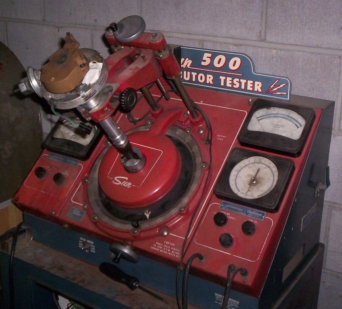

Before I sidetrack the OP's thread, what tuning are you referring to? If it's mine with old school technology (springs, weights, limiting bushing, adjustable vacuum advance cans, vacuum advance limiting plate....etc.) it's gets old working on these bits.
It was different when I had this at my disposal.
But I don't any more. Now I have to lean over the fender...
As for the HEI, the lack of a limiting bushing is problematic. More tedium to make it custom.

Old Sep 10, 2023 | 06:12 PM
skinny z's Avatar
Joined: Dec 2005
Posts: 9,917
Likes: 884
From: 53.0907° N, 113.4695° W
Re: Finally doing the nuclear option
Old Sep 10, 2023 | 06:16 PM
