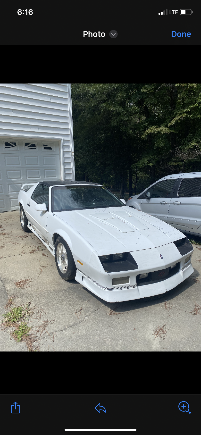

Hi there,
So I'm nearly getting this thing running.. beautiful 92 TPI. The only thing is vats because I don't have the stock ecm, but I have the original key.
I got a vats bypass module https://www.hawksmotorsports.com/gm-...-lt1-lsx-swap/ from hawks motorsports and I literally have no idea what I'm doing. I looked up the instructions but boy is this confusing.
Where do I install it? What wires are going where? I have no clue about wiring at all.
Alternatively, I watched this video:
and it seems easy with resistors. Should I just get these and make my life easier? https://www.ebay.com/itm/29596571312...Bk9SR5Skhv_sYg
Is there any other options for me?
