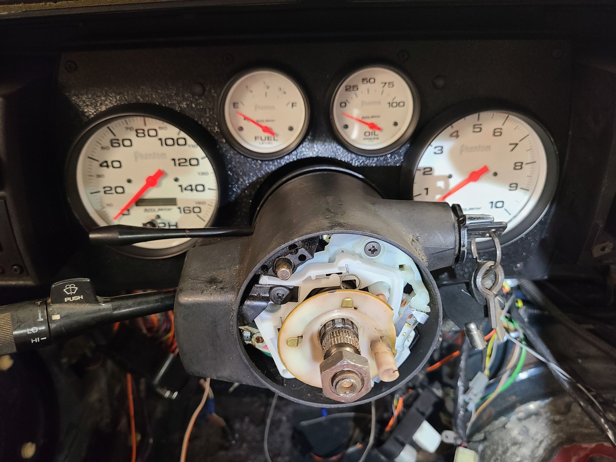

Old Jan 21, 2024 | 06:54 AM
onebdgti's Avatar
Joined: Mar 2018
Posts: 131
Re: Instrument cluster
Now i need to find a nice steering wheel to make the Phantom gauges pop.

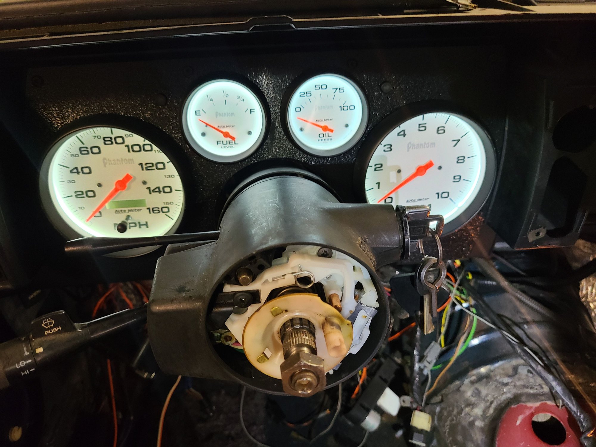

Old Jan 21, 2024 | 06:55 AM
onebdgti's Avatar
Joined: Mar 2018
Posts: 131
Here is with the lights on.
Old Jan 21, 2024 | 08:26 AM
Firechicken82's Avatar
Joined: Aug 2021
Posts: 1,181
Likes: 341
Car: 82 TA
Transmission: Magnum f
Axle/Gears: Ford 9 w 4.11
Those came out really good. Yeah, steering wheels are a tough decision.
