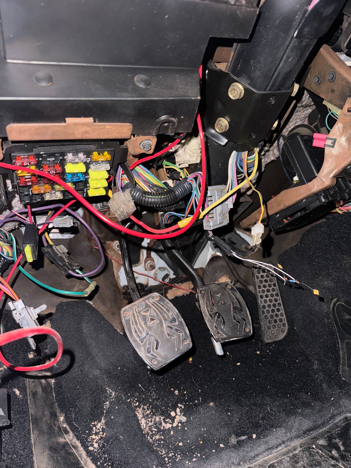

I have an 87 2.8L with an electrical problem. I’m assuming either bad injectors or bad ecm possibly. Injectors are not firing, I cheated a little and hardwired the fuel pump to the battery with my own inline fuse and switch to get it to turn on, is there any way I can cheat a little more with the injectors and be safe? I do intend to do a full engine harness replacement soon but I need it running for the next week. Previous owners chopped up the wiring on the firewall.

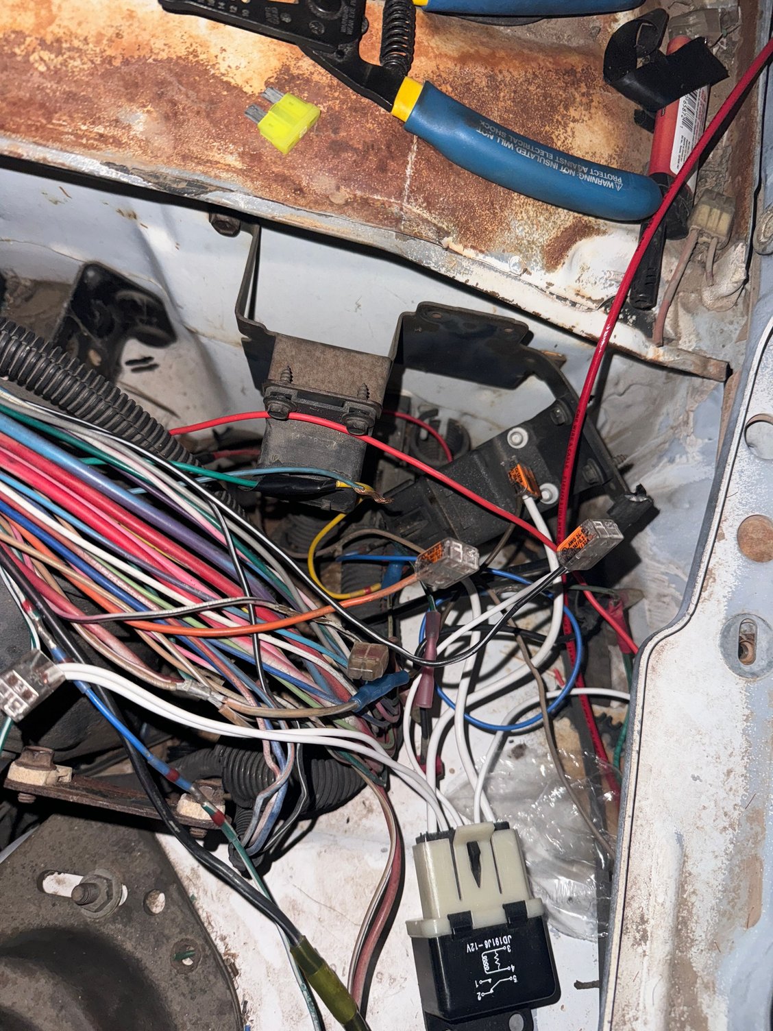

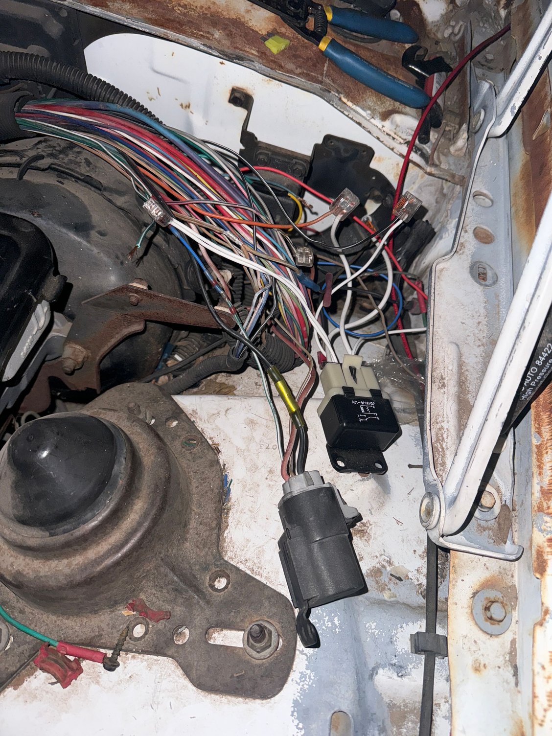

This is what I meant when I said it’s chopped up

Well then your answer is a simple one; If the previous owner "chopped up the wiring on the firewall" your gonna have to put all that back right if you want to hear it run. If that, for you, involves "I do intend to do a full engine harness replacement soon" then by all means you'd best get to it, cause there is no "cheat" that's gonna run the injectors without the ECM being properly connected.

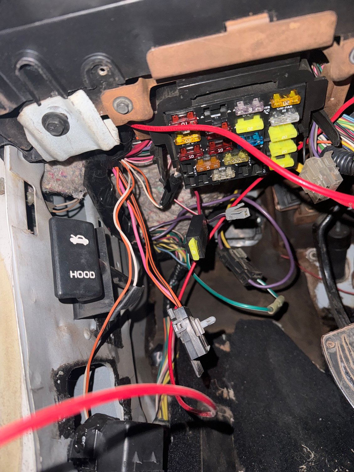

Don’t worry, I’m changing the pedals.but under the dash isn’t any better
