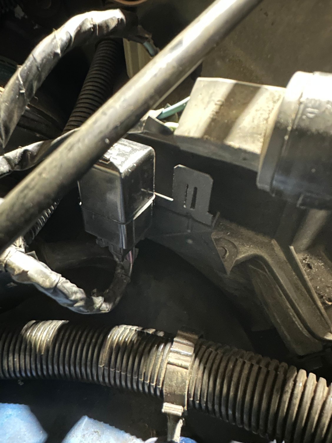

At the blower relay I have 12volts coming into relay on the red  wire terminal.
I have no power at the blower motor on the purple single wire at the blower motor.
I replaced the relay. Still the same results.

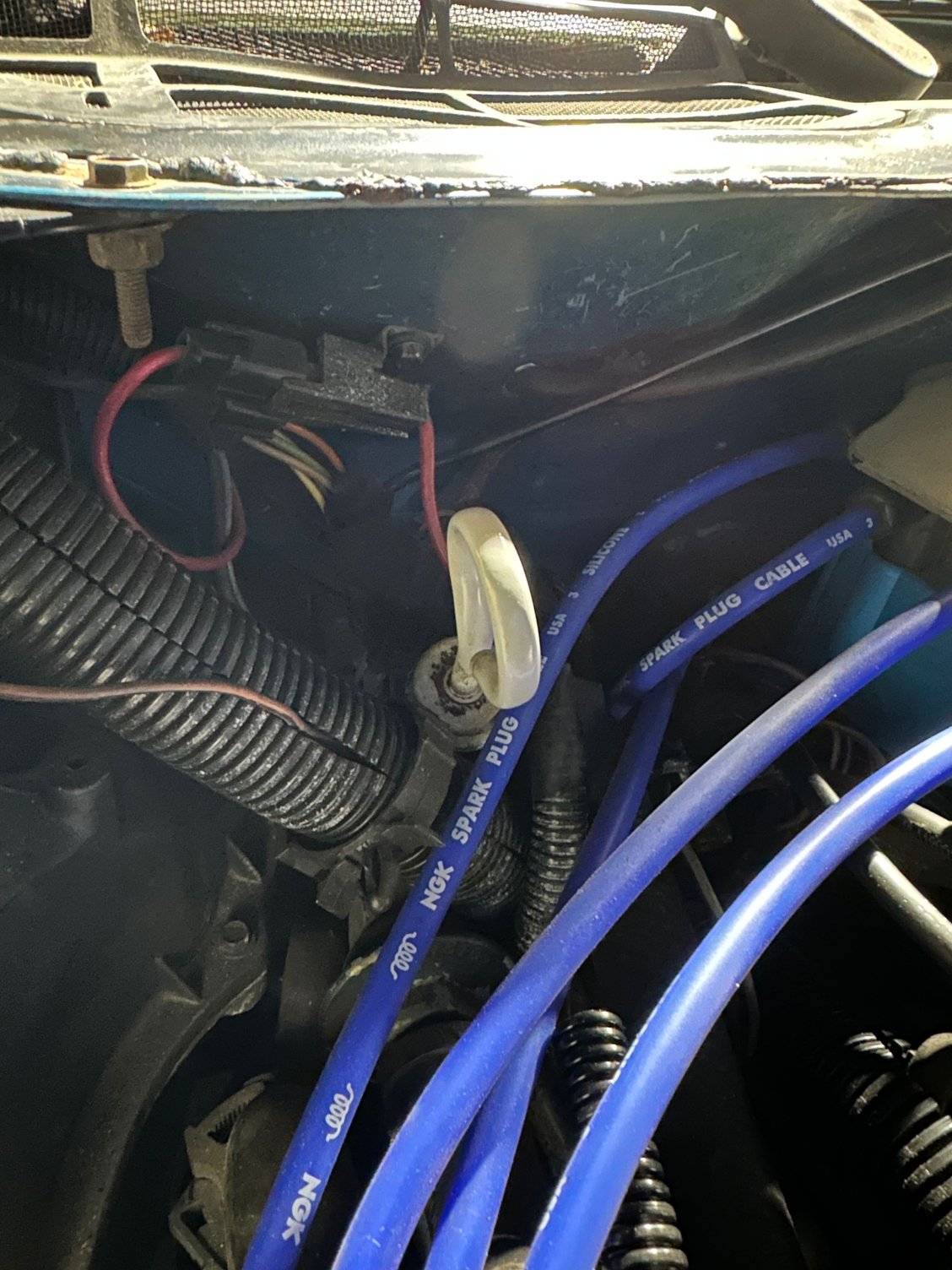

So i found the brown wire connector and it is not burnt to ashes. I did find a fusible link If I follow the red wire connector on the engine cowl towards the blower motor that has a brown wire and it looks like the fuse is blown. I will replace and report back. I was wrong. That fusible link goes to the under hood light !
I'm back to square one.
