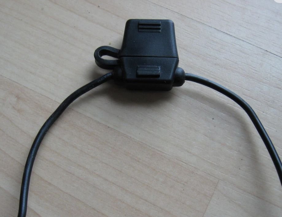

So, after doing some research I went with the inline fuse that has weather cover to keep fuse protected from elements. I am using 30amp on the large wire that the fusible link was on that burnt. The feed wire is 10 gage and the smaller linked wire is 12 gage, that wire will have a 25amp inline fuse installed. When I did AI research for the info, says yes you can replace with inline fuse that needs 30amp fuse and the smaller on a 20-25amp fuse, also I am using Posi-Lock wire connectors which are totally removable and are super secure compared to the typical crimp connectors. As for weather, well the car is not driven, at least not on purpose, in the rain. The wires will be put back into new wire loom with heat shielding from the headers and that will also keep dry for those times I would happen to get caught in the rain. The fuses will be located right by the solenoid that is mounted on the fender well so easy access if there is a problem.
Thanks for the replies and I will see how it goes. I have a new starter to install but I need to get a good pair of wire strippers that will work in the close quarters that is back near the firewall and engine.

If it’s a fuse holder like this, dielectric grease around the cap bottom would probably be a good idea.
That is what I am using and that's a good idea for die electric grease to make easier to open the cover, thanks.
