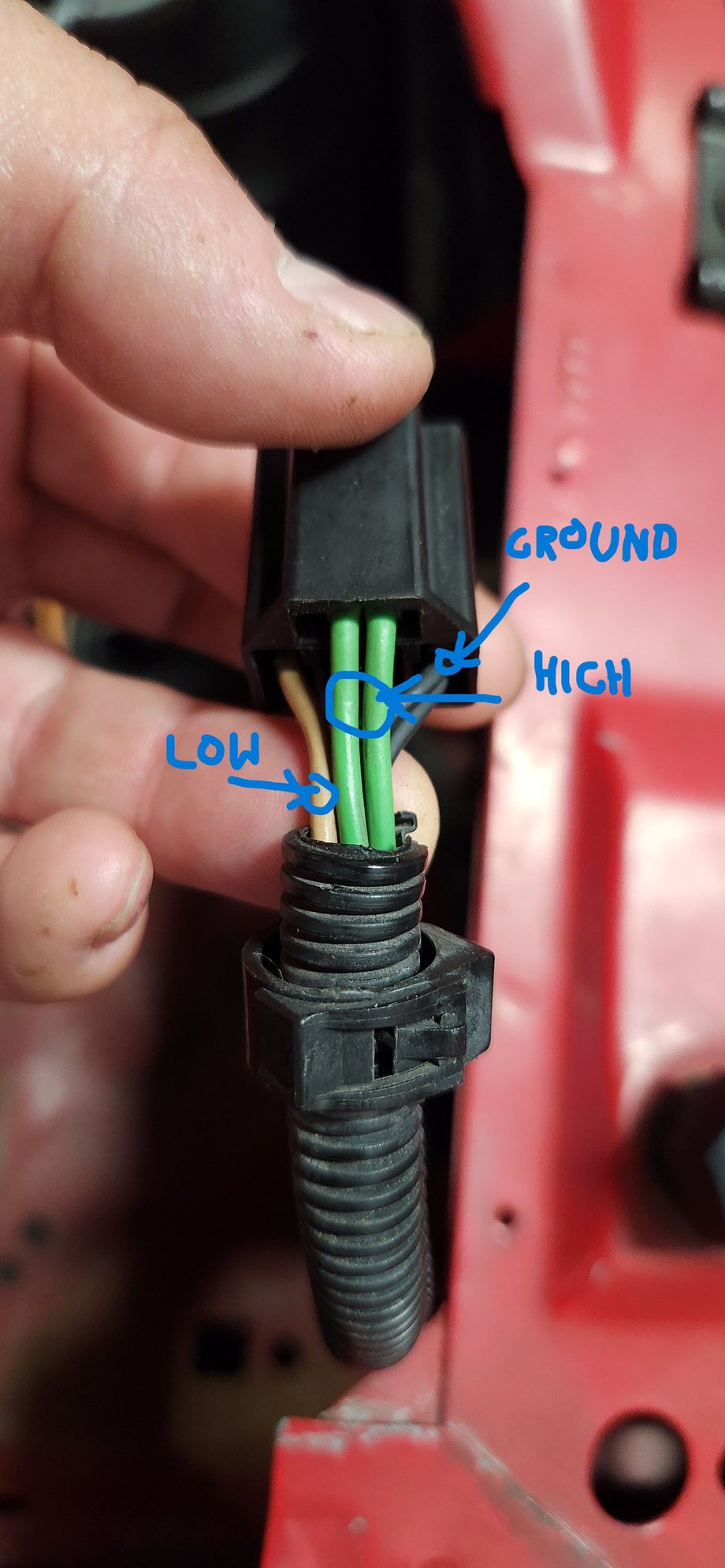

Another reason why I'm asking is because I upgraded to LED H4 bulbs and my low beam bulbs (outer lights) staying on high. So I tested the leads and the green wire is getting 6 volt feedback from somewhere, somehow ??? Like huh? That's why I'm thinking my dimmer switch might be bad maybe? But that's a very simple switch, why would it have any crossover voltage? Why 6V and not 12V if it's bad? Unless again, that's how it was designed from the factory......
and yes, I did de-pinned the green and yellow or pink, whatever you want to call it and swapped them......

if you hit the dimmer switch, are they supposed to come on?
Of course. For whatever reason you hit the dimmer switch, including that one.
Because the headlights aren't grounded. Instead, the low beams are "grounded" via the high-beam filaments. You end up with 2 bulbs in series, each dropping about half the available voltage across them.
​​​​​​​Unless again, that's how it was designed from the factory
That would be a hard NO.
Visit the headlight bulb sockets. Observe that there are some colored wires and a black at each one. Follow the black to wherever it goes. Verify that it's solidly connected, and that the connection is clean and free of corrosion, paint, or any other foreign matter. Wouldn't hurt to put a star washer between the terminal on the end of the black wire and the ground surface.

A ha!! So I do have an issue.....great to know! Thank you again for this info and of course, passed resolved issues now.....
I'm gonna get under the hood and start cleaning all the grounds.....perfect place to start

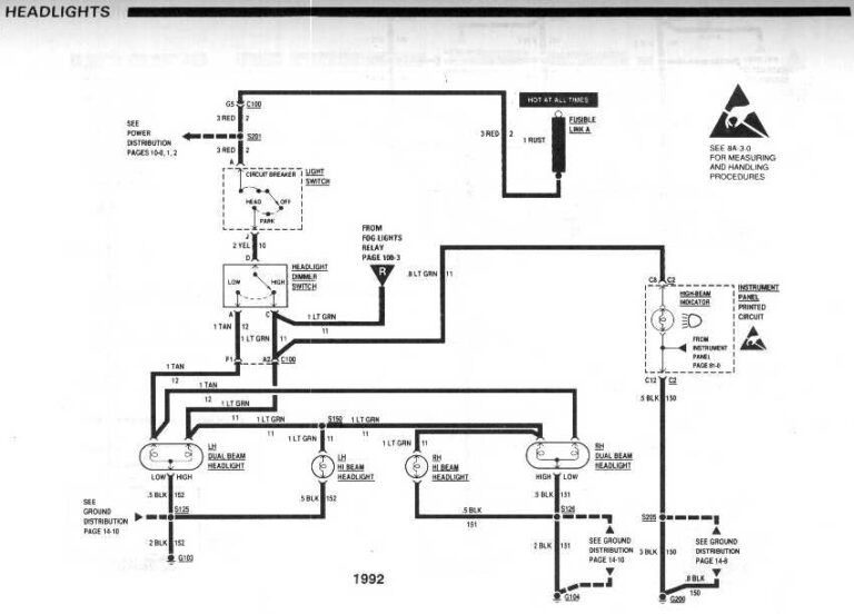

To answer your first question, with the headlight switch off, no, no amount of flicking the high/low beam lever is gonna make your high beams flash, because that functionality simply isn't wired into the system, such as it is on modern cars.
Please take a close look at your 1987 headlight wiring in this diagram for the answer. When the headlight switch is off, there is no power being fed to the headlight dimmer switch, and there is no other electrical provision to provide the headlight dimmmer switch with power to light the high beams when the headlight switch is off. I realize you have a Camaro VS the Firebird wiring shown, but minus the headlight door wiring of the Firebird, and the 2 VS 4 headlights of the Firebird VS Camaro, both car's headlight wiring is the same.
Bottom line = no other source of constant power power available to the headlight dimmer switch while the headlight switch in the off position (and no other set of switch contacts for the high beams to make use of that presently not available constant power source) means no flashing of the high beams when the stalk is pulled. There are no "features from the future" wired into our cars...

In closing, I'll present the 1992 Camaro headlight wiring. As you know, 1992 was the last year of our beloved third gen F bodies, and even the 1992 cars had no provision for flashing the high beams with the headlight switch off.....

No, I was referring to my second issue with the lights. (My LED bulbs in Lo beam setting, have hi beams on....tested the hi beam green wire and shows 6 volts somehow)
I'm gonna trace wiring and clean the grounds, wherever they might be.....just for $hits n giggles, I'm gonna change the dimmer switch with a NOS OEM one and see if that changes anything.....I'll update when I get it checked out hopefully this week ......
