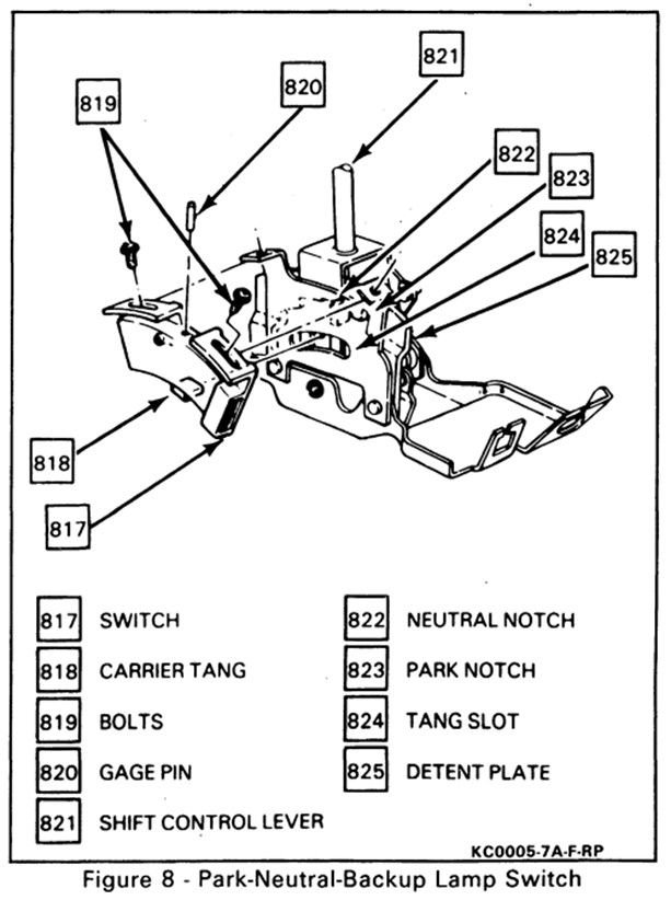

This is from the 1991 Camaro service manual.PARK-NEUTRAL-BACKUP LAMP SWITCH
See Figure 8
1. Remove or Disconnect
1) Negative (-) battery cable.
2) Console.
3) Mounting bolts (819).
4) Switch (817).
Switch Adjustment Using Old Switch
2. lnstall or Connect
• · Place shift control lever in "NEUTRAL."
1) Carrier tang (818) on switch (817) with tang slot (824) on shift control.
2) Mounting bolts (819) to case, loosely.
• Rotate switch (817) to align service adjustment hole with carrier tang hole.
3) Gage pin (820) 2.34 mm (3/32 inch) into service adjustment hole and rotate switch (817) until gage pin (820) drops to a depth of 15 mm (19/32 inch).
3. Tighten
• Mounting bolts (819) to 2 N · m (18 lb. in.).
4) Console.
5) Negative (-) battery cable.
Important
- After switch adjustment, verify that engine will only start in "PARK" or "NEUTRAL" If engine will start in any other position readjust the switch.
Switch Adjustment Using New Switch
1) Install or Connect
• Place shift control lever in "NEUTRAL"
1. Carrier tang (818) located on switch (817) into slot on shifter.
2. Mounting bolts (819).
Tighten
• Bolts (819) to 2 N ·m (18 lb. in.).
Important
- If bolt holes do not align with shift control verify shift lever is in "NEUTRAL" position. Do not rotate switch. Switch is pinned in the "NEUTRAL" position. If switch has been rotated and the pin is broken the switch can be adjusted using the "Switch Adjustment Using Old Switch" procedure.
3. Console. Refer to INSTRUMENT PANEL, CLUSTER AND CONSOLE (SEC. 8C).
4. Negative (-) battery cable.
You should be able to back probe the switch conductors to check it electrically I hope, since I haven't had to check mine.
