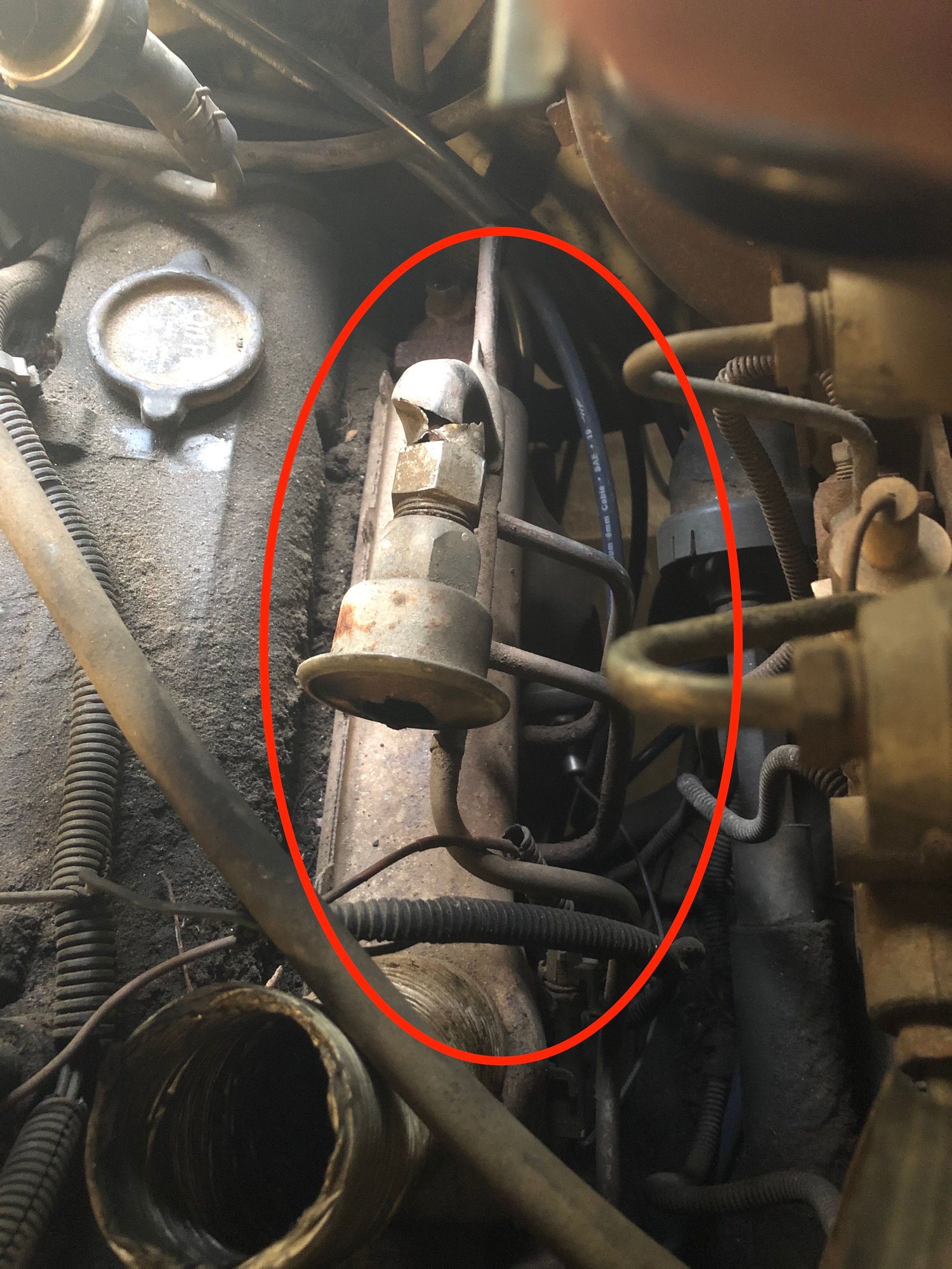

Sorry y'all, I'm not sure what this is 100%, but I know it has to do with the vacuum system since it connects to the exhaust manifolds. Does anyone happen to have this, or know where to find it? It's off a LG4 engine (drivers side). I have a picture posted below (sorry if it comes out massive or minuscule, I'm not 100% sure how to use this thing). I popped the intake filter cover and unit off and noticed this.

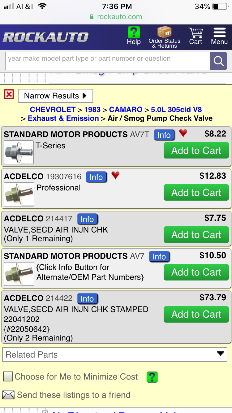

Have you looked at rock auto. It’s for the air pump .

https://www.rockauto.com/en/catalog/...tion+pipe,4904

Oh it is? Sorry, I'm not use to working on cars (I've rebuild tons of bikes though). I know someone it this car's past disabled the smog system (removed the belt).

If the air pump belt is gone you can remove the pipes from the exhaust manifold and use inverted flare plugs to plug the holes.
