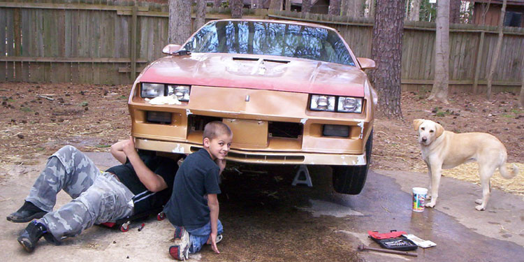

I've had to catch up on some of the "Honey Do List" around the house for the past week. I'm heading out of the country (to Japan) for a work related trip and needed to put the Z28 on a "Partial" hold for a week or two. I assigned my son several projects and he's been doing pretty good with a few pointers here and there. He also enlisted the help of his little brother Karl and the dog
(see attached photo)
Although the dog only barks and drinks your soda if you're not looking...LOL LOL LOL. Derek will learn to put it on the roof next time LOL LOL LOL LOL.In two weeks, when I'm back from Japan one of my employees is going to bring over a cherry picker from the plant and we're gonna get the motor and tranny out of the car. Until then, my son(s) get to remove the ground effects and tackle a few other projects.

Here's the piece prior to primer..... We had found one (also gold)at the J.Yard that was also damaged but in different locations. Derek cut the front off our original and fibered the front from the J.Yard piece to it. Old piece in on the left. New complete piece on the right. He may have sanded a little too much off of the corner but no one will ever notice.
Kurt
