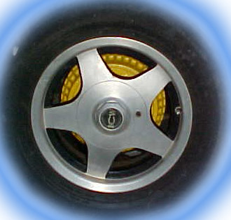

As planned we worked on brakes the past weekend ++. It turned into a monster project . After we disassembled the brake drums we realized that the previous owner had installed much of the hardware improperly. In addition we found several other problems. In the end we replaced; 1.) Shocks 2.) Sway Link Ends 3.) Wheel Cyls., 4.) Shoes 5.) Brake Lines 6.) Rear End Cover Gasket & Oil 7.) Wheel Bearings & Seals 8.) Bolts that broke during disassembly 9.) My son Painted everything UGLY!.
My son replaced the shocks and sway link ends by himself. Reminder: Never tell a 15 year old to hold the top of the old shock with a vise-grip to hold it while loosening the nut. You guessed it..... Trashed threads at the top, nut impossible to remove.... HACKSAW time!! I learned to give PROPER instructions.
We took all the parts to my plant and HE Bead Blasted them free of rust and crud. Then HE painted the ends of the Drive Shafts and the Backing Plates Gloss Gray, the Drums and Rear End Cover got and UGLY Gloss Yellow. We worked together to put all the springs and such back in the proper locations using the Chiltons. I held the shoes as HE installed the springs, retainers etc. The bearings, seals, and drive shaft re-install was done my me with the rented slide hammer and a Mapp Gas Torch..... I had to let him watch that part. We also had to go to the junk yard to get replacements for the axle pin retaining bolt (also vice-gripped to death by the previous owner).
All-in-all we only spent about $150 and we were together all weekend. The parking brake actually works and the brakes seem to work quite well.
Over the next few days Derek gets to CLEAN all my tools and place them back in the PROPER locations in my boxes. This weekend we'll double-check the bleeding of the rear brakes and maybe spend a little time evaluating our engine plans.
We'll be back with proper engine swap/info questions this weekend.
I'll try to post a picture of the UGLY drums and Rear.

Thought you'd be tired of the Drum Photo.... This is the way my son see the "Ugly Yellow Drums" not too bad after the rim is on...

Don't worry about the yellow, he will put the wheels on and look at it and be like o ***, and paint in the first it its running, or he will get another car and remeber not to paint things bright yellow.

P.S. The Yellow Drums really don't look too bad.....
