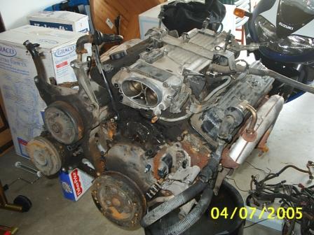

I just picked up an LT1 out of a 94 Caprice complete with EVERYTHING except the PCM to put in my 92 Vert. But while I was at it I thought about how hard it would be to switch over to OBD II? I would like to use the newer system. I like the extra diagnoses capabilities of OBD II. But for Smog legality I was wondering if I am going to have to have a working Evaporative monitoring system. That would suck. I do know I am going to have to a) take my car to a smog referee for the swap. I then would need ALL the existing emissions equipment for it to even pass a visual. OR b) get a smog license myself and then just pass the thing myself as long as it doesn't have to go to a test only station. I already have all my regular ASE's and my L1 advanced engine performance so all I'd have to do is take a few classes at the community college and take the test with B.A.R.
Would going to OBD II just require a few differant parts and sensors? Or would it be not worth my effort? Does the OBD I system on the 94 monitor misfires since it is Opti-spark? That is what I really like about OBD II so I don't have to hunt down why i have a rough running engine.
Any info appreciated.
