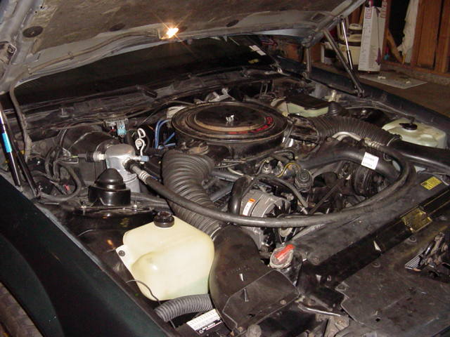

good work on your swap. This latest pic almost had me thinking I was looking at a 307 w/all the hoses running around......

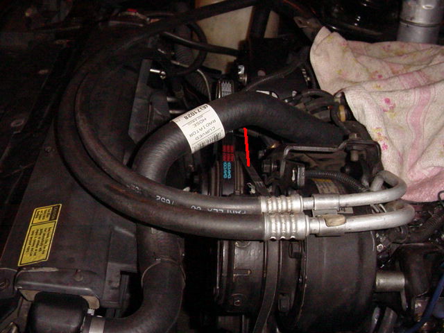

Five7, that upper rad hose looks real close to the A/C belt. I can't see from the pic if you have a guard installed but if you don't you can get one from a Chev Dealer #10055001. When that hose gets hot is sages a bit and sometimes comes in contact (bumps ect.) with the belt which will rub a hole in the hose. Good insurance. I feel for you with coolent coming out of #7. I had the same problem when I hit the button for the first time. I noticed foam in the coolent resivore so I removed the rad cap, filled the rad up to the top and did a cyl leakdown test. When I got around to #2 and put the air to it air bubbles came out of the rad. Bummer. I called Fel-Pro and they said to use head bolt washers (oiled) and torque the head bolts in three stages to 60#. Waite 24 hrs and retorque the bolts to 65#. Haven't had a problem since.

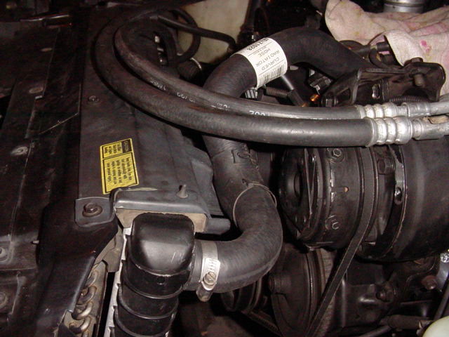

Here's a different angle, to put your mind at ease.

The hose support is built into the upper radiator support.
