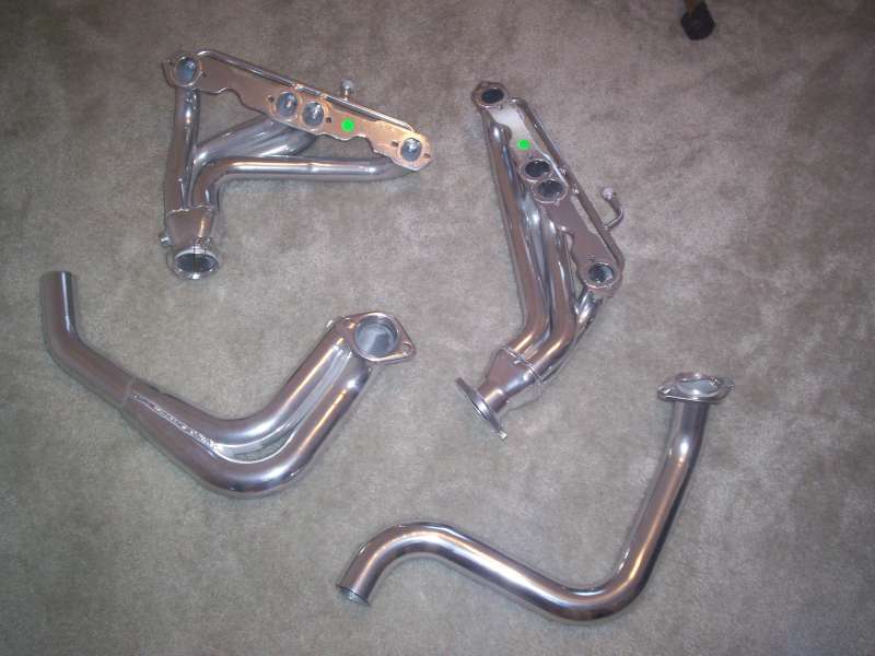

My Mechanic stats tomorrow swaping my 305 Lg4 for my new bulit 350/355 the block came out of a 1974 Z-28 there takeing out all the smog crap. I got some pace setter headers i order from jet hot so they should go good with my high flow cat 3 inch pipeing flowmaster 80s muffler. How many HP do you think i'll have? Well it be a big diffrance from my Lg4 with 181,000 miles? Thanks

The small Pacesetter primaries will limit HP. You'll probably have more than the LG4 had, but probably not as much as possible with better headers.

The cam is a "151" cam, used in the L79 in the mid 60s its brand new. The heads are stock but had them rebulit they are like new whats wrong with the pace setters headers i bought them from Jet hot some of my buddy's with camaros gave me 2 thumbs up?Still be a world of diffrent from the stock stuff right?
