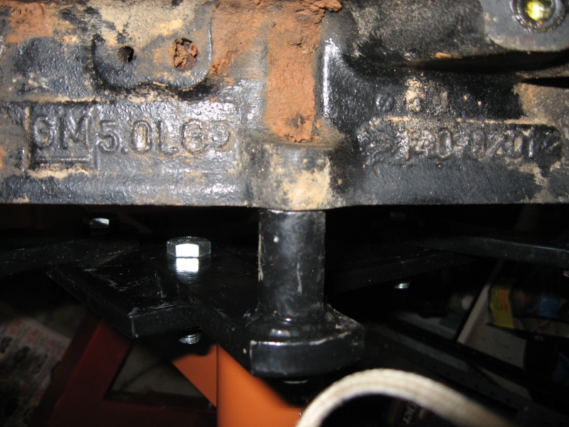

If I'm reading the casting # right, that's a stock '85 305 block.
Truck blocks are roller casting, but typically haven't had the roller provisions machined. Passenger car blocks '87-up should be roller lifter, as well as truck '96-up.

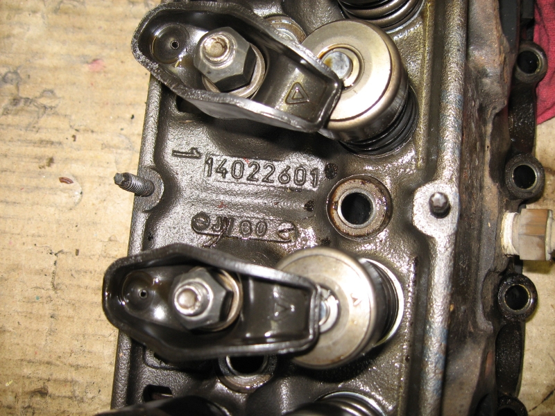

Thanks 57. With that information I'll start my hunt for an 87+ 350 after Christmas presents are paid for. I'm beginning not to trust this 305 block anyway. (see below)
Those numbers are difficult for me to read. I did a tracing with paper and pencil to see if I could get more out of it. I thought the 85 Z28 was supposed to have an "LB9" engine but I read: "GM 5.0LG?". The other number "140??201" (must be 14010201) shows as a 1980-84 at http://www.nastyz28.com/sbchevy/sblock.php and as a 1980-85 at http://www.mortec.com/castnum.htm.
I'll buy a micrometer in a few days and check the bore size to see what they've done to it.

I believe I did find the (major) problem with this engine. Recall it was rebuilt but never ran right afterwards. Probably a few hundred miles on the rebuild before it was parked for good. One plug fouled constantly. I found a hydraulic lifter that has lost its retaining pin. The lifter was expanded. It probably kept that valve open most of the time.
Drained the oil before flipping it over to pop the oil pan and what did I find? About a quart of coolant along with frothy brown coolant-contaminated oil. I'm racking my brain on how it got in there without a coolant passage being cracked. Head gaskets were not blown. This may be just the excuse I need to upgrade to a 350.

Thanks 57, I'll take your advice and search for the 350. Right after christmas anyway. I need to get a Big Wheel, Fisher Price Cash Register, Dora the Explorer playset etc etc......first.
If I find no cracks, I'll rebuild this 305 short block too just for the experience/fun and so it won't get junked. Won't put it in my car though.

In general, my advice is to not do anything to a 305 that can't be transferred over to a 350. I found that my 350 gets as good of mileage as my hopped-up 305 did, which of course isn't as good as the stock 305 got.
Go ahead and work over the heads - 1.94" intake valves, port clean-up, new valve springs & seals, screw-in or pinned rocker studs. Nothing wrong with TPI and cam upgrades. But, if you spend any money on the shortblock like rings, bearings, pistons, you'd be better off finding a 350 shortblock and doing those things to it. You won't have any problems if you keep the compression the same as your stock 305, 9.5:1. That will mean dished pistons if you run your 305 heads (which will probably be better than heads you'd get on a 350 core).
