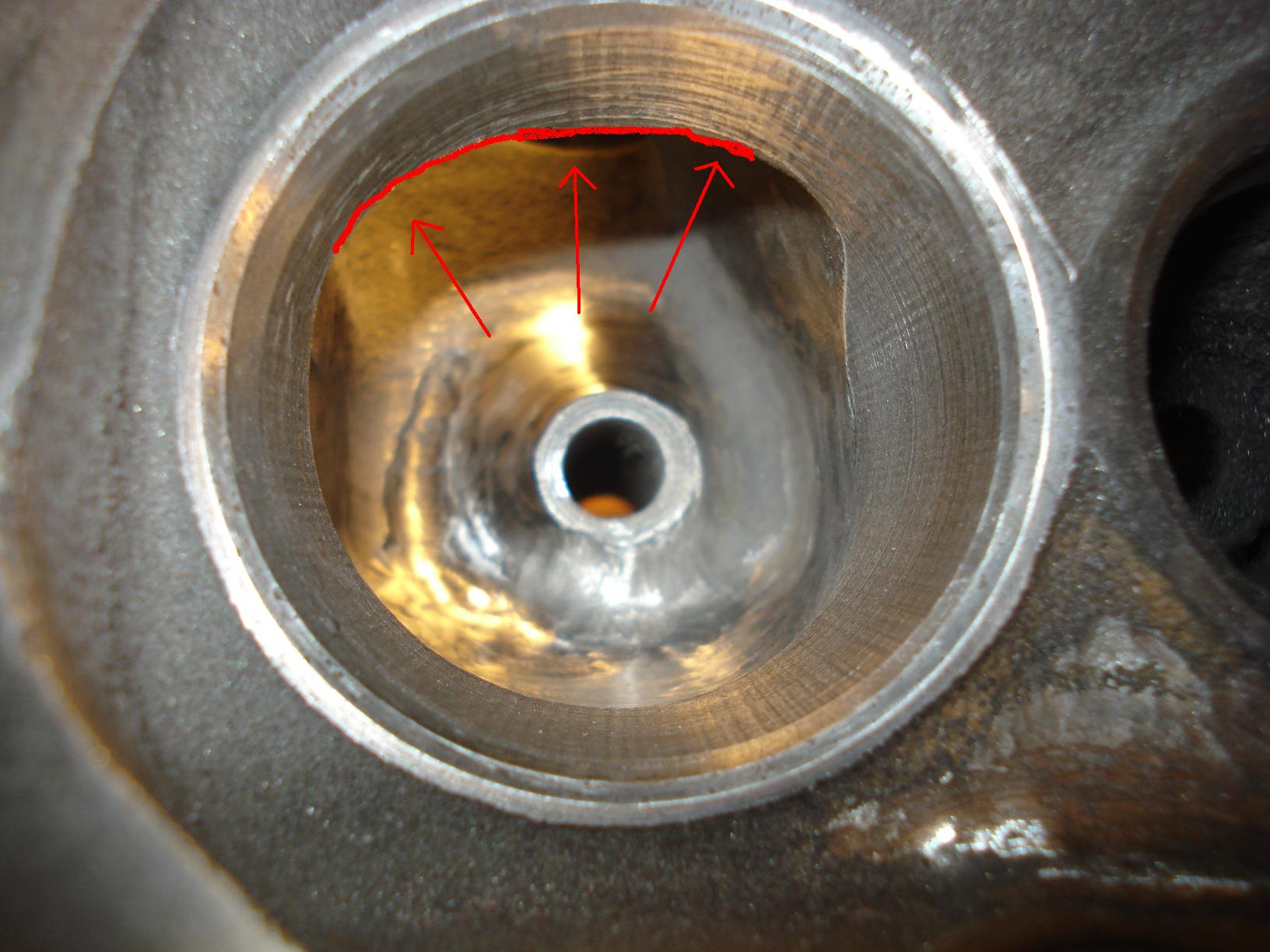

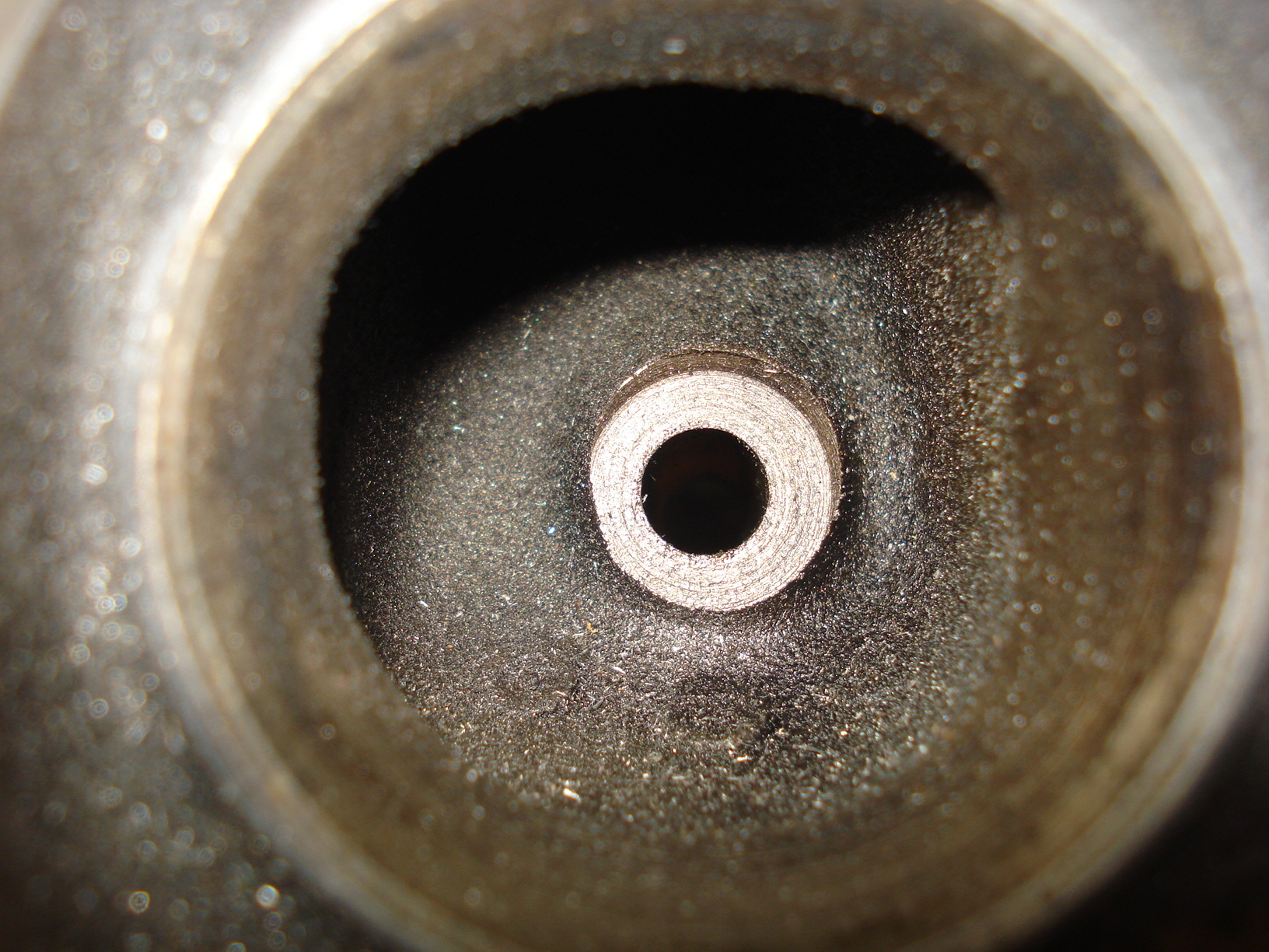

Good info on both articles. I had previously read the first one, and took my tips from there. Here are a few pics of what ive done in roughing in the basic shape. If this looks pretty decent to anyone, I will continue on to the rest of head. If I have trashed them already I will have to start searching the boneyard for another set of heads.
Concentrate on the short side radius.
Well, it could be argued that they were trash before you started. . .

Is the red area the short side radius area? lokks like it should be rounded back and up a bit to get rid of the sharp corner at the transition.
Yes.
