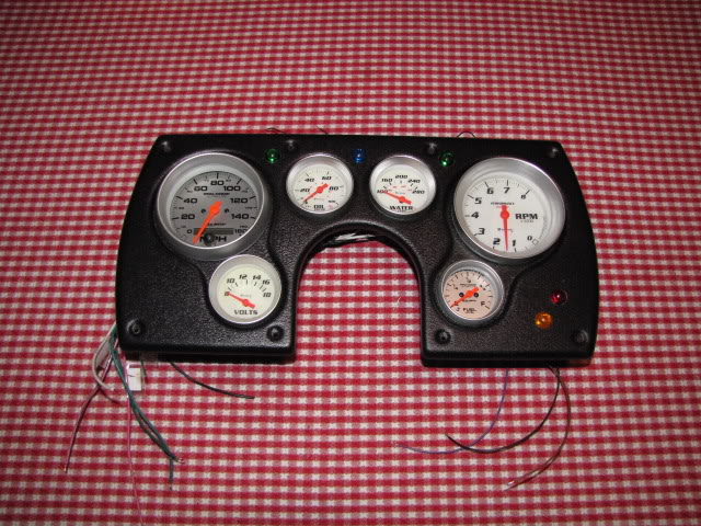

I'm going with a custom dash panel and tach so i'll be wiring to the coil like normal.
So did I, for my LS1 swap. You can use the factory wires for engine temp (I did), tach (I didn't because the LS1 source for tach signal came into the passenger compartment in my case), and oil pressure (again I didn't, because my oil pressure gauge is mechanical).

Is there even a tach wire in a V6 sports coupe car?

I'll have to admit I didn't think of that. My V6 car had a tach, but not all did. If yours didn't, then it probably doesn't have the tach wire. Only way to know is to look for it.
My V6 to V8 swap included a donor car. I transferred all of the V8 wiring over, including the ECM and dash harnesses, so I didn't even think about a lot of these things.

I'm not too worried about the tach, i can run wires, i'm pretty good with electronics. I've run a tach before, and other gauges, along with my own car audio systems and others, and i'm about to break 18 years old.

All the other crap, what can i trash? Its going to be a no AC, No nothing. Alternator, Power Steering, carbed 350. I've got to have something to run lock-up. I guess its not manditory, and dosent HAVE to have it.. but it'd be nice.
I'm running aftermarket gauges so i'll probally go ahead and run my own wires for that too. So what do i have to leave?
